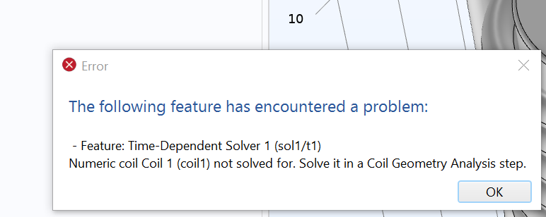

Coil geometry analysis step not solved for
Hi, i tried simulating an inductive heating case and i got this error , anything i could change to fix it?

I don't deal with coils often, but... based on the exact words in the error message you posted, my best guess is that you did not include a necessary "coil geometry analysis" study step. To see an example of how to implement that, take a look at the "Inductor_3d" model, available in the Comsol-supplied Application Library. I hope that helps.

I concur. It may also be necessary to add some sub-nodes under the Coil Geometry analysis.
If this doesn't help, post your model.
