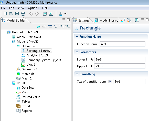

i want to generate a rectangular pulse train of pulse width = 28e-9 , frequency = 1 Hz
i used the rect function along with mod function to get an analytic function an1= rect1(mod(t[1/s],1e-9))
but when i plot this for time t = 0 to 1 sec i get zero magnitude , after solving i also found out that heat flux is zero throughout the time . I also tried 'make periodic' option but still not getting the plot.

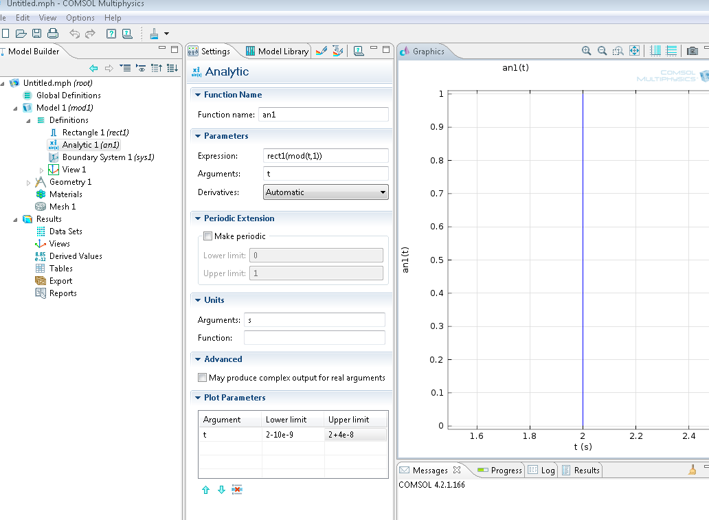

you can aleways combine a rect with a mod(t[1/s],1) see images
Do not forget to carefully define the time sequence and use strict and not free time stepping
I suspect the ration 1e-9 to 1 is too large for the analytical function, try asking "support"
