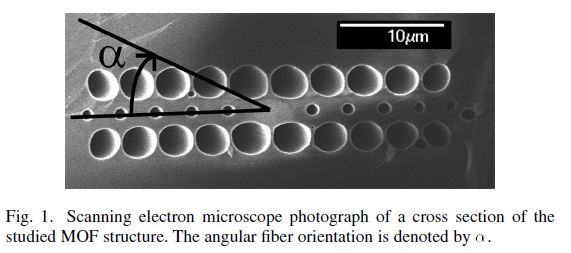

I am doing simulation of the NEMO fiber( I have attached the SEM image from Geernert et.al. IEEE photonics letters,20, 8, 2008) with dooped core( defect in the centre).
I have put a rectangular PML around the airholes so as to enclose the microstructure,
If I give assign the PML refractive index the cladding refractive index I do not get fundamental mode at the expected mode index but if I do the same with air refractive index I get the results.
I do not know exactly as to why the air refractive index for PML works even though its inside the cladding. Can someone clear my doubt?
Akhilesh
