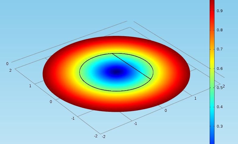

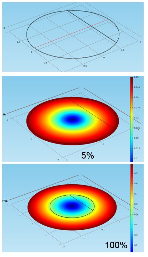

Again, I have the membrane and I stretch it by a percentage of its original radius. I have 2 different stretch factors.
- 0.05% and 100% [for illustration purposes more than anything]
For both of these, the membrane is stretched past its original shape. As shown in Image 1. So I know that the model is being stretched, but am having difficulties extracting stress values.

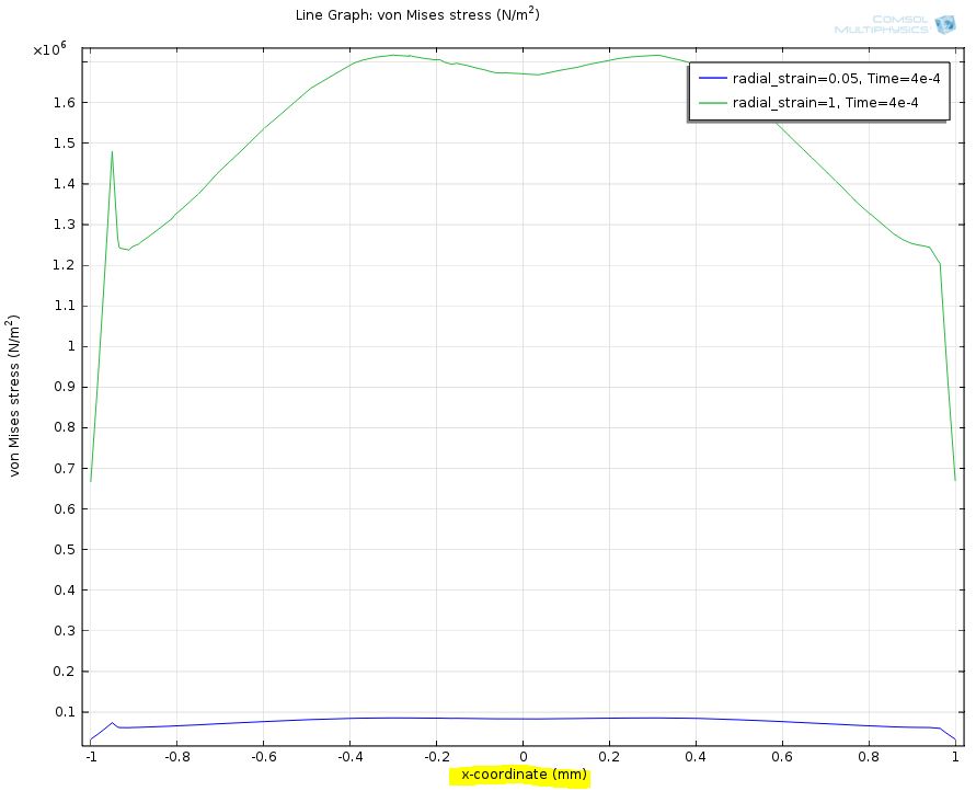

Then, when I wish to plot the Mises stress through the middle of the membrane, shown in Image 1. And I plot them, I get the problem shown in Image 2 (the x-axis shows that the deformation is not 5% and 100%).
The diameter of the membrane is 2mm, so I would expect the x-axis "Displacement field" to be -2mm +2mm for 100% stretch and -1.05mm +1.05mm for the 5% stretch.

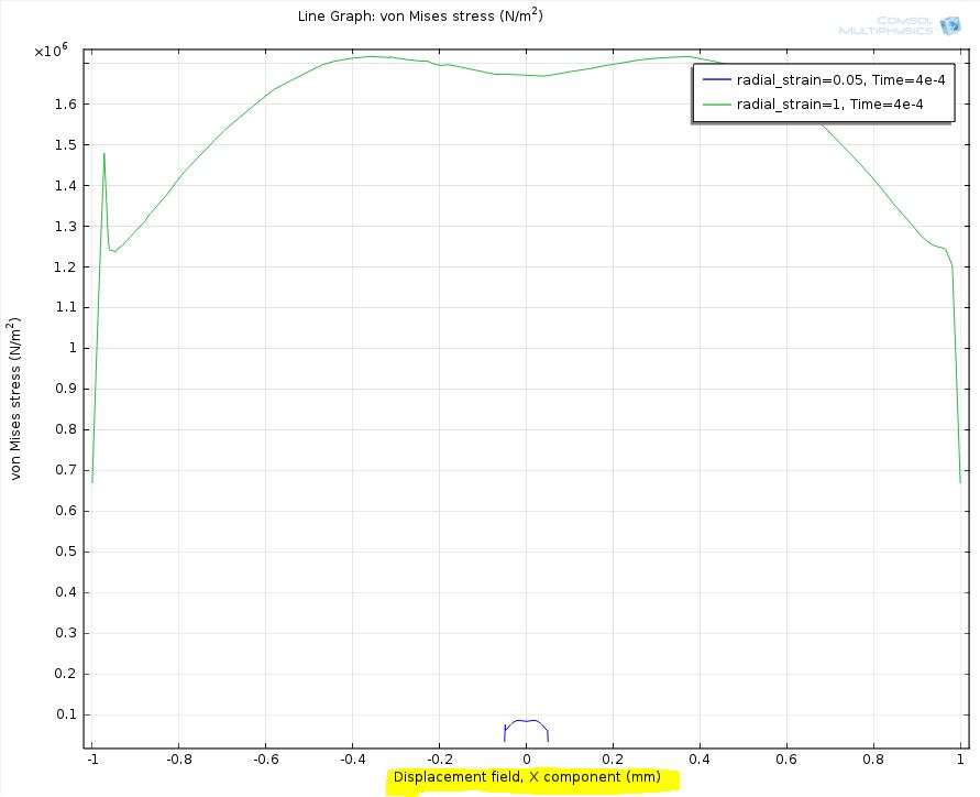

In figure 2, I have plotted 'u' in the x axis, as the expression. Plotting x or X, is shown in Figure 3. Figure 3 is the most confusing for me as it shows the stress within the membrane but to me it looks like its suggesting that both membranes are the same size (which from figure 1 is obvious that they are not).
This is quite confusing. Any suggestions?
