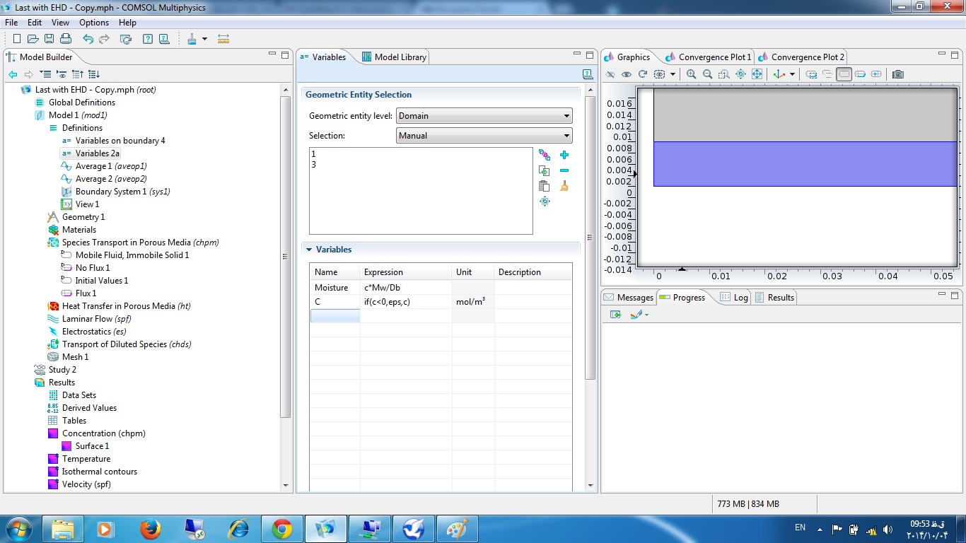

Posted: 1 decade ago Dec 9, 2013, 5:34 a.m. EST
if(c<0,eps,if(c>1,1,c))
Dear Tero,
First i would like to say thank you because ,i am doing my MS project "modeling of electrosorption" using comsol version 4.3 at Hindustan Unilever R&D,Bangalore and i got the same problem of getting negative values or larger values which are not expected.I searched for resolving this problem in various literatures and available comsol materials but i did not find anywhere and finally i found randomly here(discussion forum) and i tried it and its working well.But i have a few doubts about defining this condition.
(1)How much small number is this eps? or is it constant small number?
(2)what is the condition if c lies between 0 and 1 i.e (0=<c=<1) (here =< represents less than or equall)?

Here is one trick to solve negative concentrations.
I made variable "C" which is defined by "if(c<0,eps,c)" under Definitions => Variables. Instead of concentration "c" I used variable "C". Now variable "C" is never below zero. Eps is very small number defined is Comsol.
Does this help you?
Best regard
Tero

Posted: 1 decade ago Jun 20, 2015, 7:46 a.m. EDT
Does this help you?
Best regard
Tero
What do you mean by - [Instead of concentration "c" I used variable "C"]?
Did you replace "c" with "C"? But c is the main variable.
Can you please elaborate?
I'm sorry, my doubt might be trivial since I'm new to COMSOL.
Thank You,
Shiva
[QUOTE] Hi, Here is one trick to solve negative concentrations. I made variable "C" which is defined by "if(c
Posted: 1 decade ago Jun 20, 2015, 11:05 a.m. EDT
(1) C=if(c<0,eps,c). No problems caused by negative ion concentration. However, there is a time step within which the maximum iterations of (constant damping) newton's method has been reached. (Resolved by C=if(c<0,1E25,c))
I believe that I'm trying to solve the same set of PDEs that you are trying to solve as well. Can you please let me know how did you use 'C'?
It is clear that 'c' is the variable that we declare for the number of species in the drift-diffusion PDE. But after you define 'C' as 'if(c=0,eps,c)' or 'if(c<0,1E25,c)', how do we use it? I mean, are we supposed to replace 'c' with 'C' anywhere?
I have simply defined C=if(c=0,eps,c) as a local variable for all the domains where the species exist but still can find negative values of 'c' as and when the the solver solves.
And also which solver would you recommend? I tried both MUMPS and PARADISO. Unfortunately, each solver gives different results.
I'd really be grateful if you can help.
Sincerely,
Shiva

Posted: 9 years ago May 2, 2017, 6:47 a.m. EDT
I know it is in response to your very old post. But I also have the same negative concentration. And I am not able to incorporate the trick you suggested in this post. How do you have 2 variables for concentration c and C?
Hi, I know it is in response to your very old post. But I also have the same negative concentration. And I am not able to incorporate the trick you suggested in this post. How do you have 2 variables for concentration c and C?
Posted: 9 years ago May 5, 2017, 2:56 a.m. EDT
I haven't use Comsol for ages but I try to remember how this was done.
Yes, I have two variables where "c" is Comsol own parameter and "C" is new variable for calcuation purposes. "C" is used in reactions to prevent negative concentration and it is never below 0.
Did this answer to your quoestion?
Best regards
Tero
Hi, I haven't use Comsol for ages but I try to remember how this was done. Yes, I have two variables where "c" is Comsol own parameter and "C" is new variable for calcuation purposes. "C" is used in reactions to prevent negative concentration and it is never below 0. Did this answer to your quoestion? Best regards Tero
