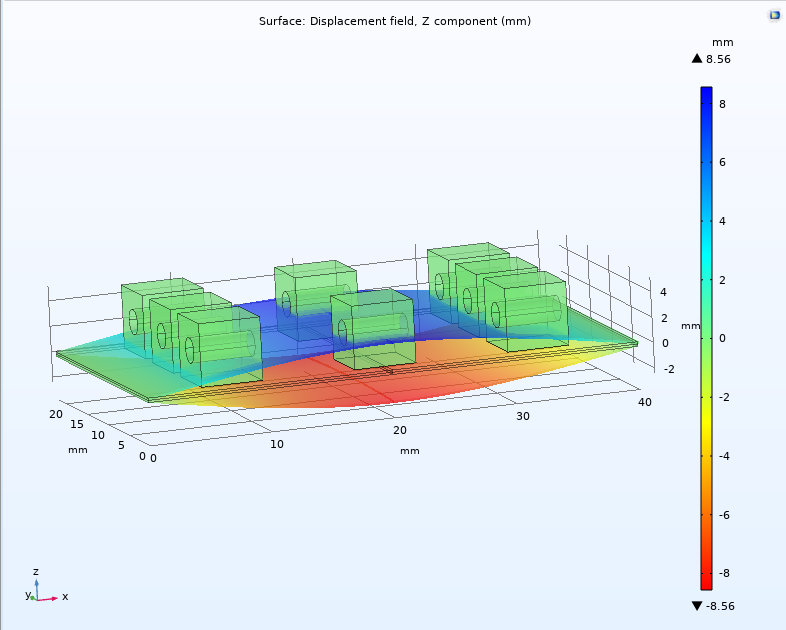

Hi all,
I am fairly new to COMSOL but i am struggling with form union vs form assembly. Is there a way to union some of my objects i have created, and assembly others?
In my problem shown in the photo as you can see the cubes should have a union with the top sheet, and that union should have an assembly with the bottom.
there is a force applied to the top and bottom sheet in the opposite direction. Any advice would be much appreciated.
