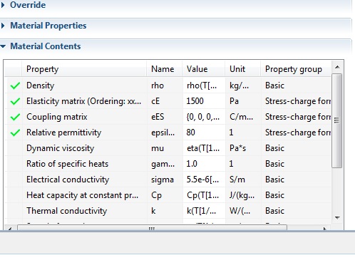

I am using the PZD physics to analyse my system- which is one rectangular block of PZT5H and another block of water just adjacent to the PZT5H. Now when I select the materials- because it is PZD - the properties of water show a user input for "coupling matrix" (as you see in the attachment jpeg). So I dont know what the is the significance of the coupling matrix and i cannot find the specific values. If i put a {0, 0, 0, 0, 0, 0, 0, 0, 0, 0, 0, 0, 0, 0, 0, 0, 0, 0} matrix - what will it mean.
I am not sure if I am clear now. but feel free to ask again...I will my best.

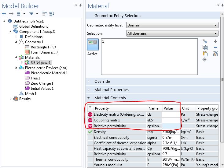

I am new to the COMSOL(4.4) and working in structural mechanics (Piezoelecctric Devices PZD).
I am trying to use the material Silicon Nitride (Si3N4) [ under -Add Materials -MEMS- Insulators- Si3N4].
I am having trouble with the values - Elasticity matrix, Coupling Matrix & relative Permittivity of Si3N4.
I am attaching the print screen of that window.
Please let me know the values or let me know the link where I can find them as I searched a lot but I am unable to find the values of these parameters.
Thanks
Anurag

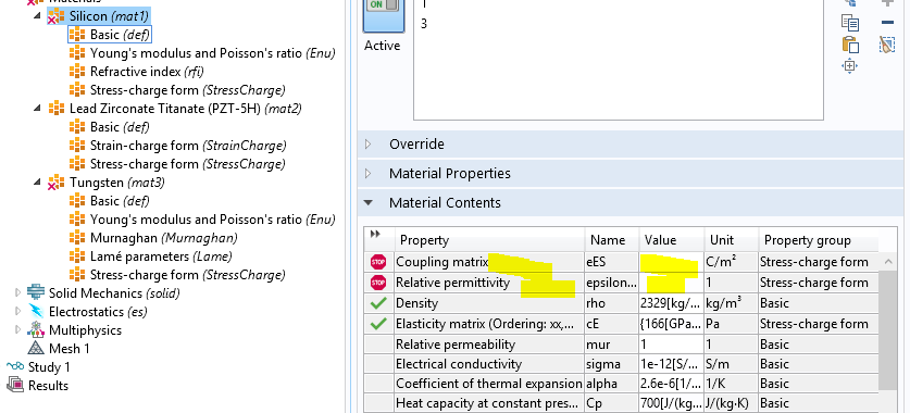

it will be highly appreciated if anyone help to solve the marks point in the attach photo, I am looking for the 1. coupling matrix, elasticity matrix, relative permitivity for silicon
2.coupling matrix, elasticity matrix, relative permitivity for tungsten.
I am using COMSOL 5 using piezoelectric device.

Silicon and tungsten are pure metals (not compound ones) and hence not piezoelectric.

This issue seems to come up often. A piezoelectric material is one where the electrical and mechanical domains are coupled (through the coupling matrix!). Ordinary non-piezo materials do not have that coupling. You need to make these materials linear elastic materials.
If you look at the shear bender example you will see how these settings are done.
