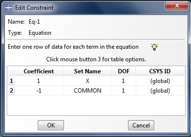

how to apply linear contrain equation to the node set
I want to make FEM model of unitcell of viscoelastic composite.
i don't know how to apply linear constraint equation in comsol.
Linear constraint Equation:
(ui^a)y - (uj^b)y = 0
where,
superscript a, b are node no.
subscript i, j are degree of freedom
In abaqus

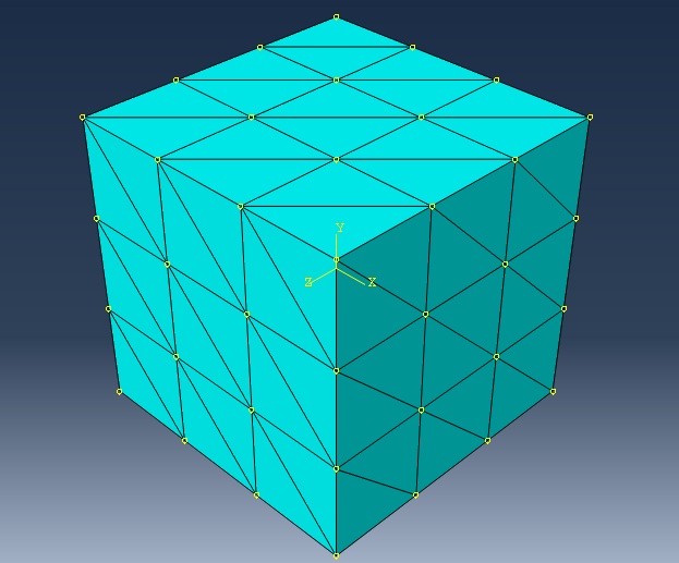

i have attached 1 jpeg file in that 'x' [set of all node of x=1 plane except common node (1,1,1)].
similarly i have apply linear constrain in y=1 and z=1 surface of cube.
how can i apply same constraint in comsol.
please reply as early as possible.

i have attached the document.
can i able to do same in comsol (i.e momentum equilibrium)
the thing i mention in attachment is what exactly achive by contraining node set.
thanks for reply i have attached the document. can i able to do same in comsol (i.e momentum equilibrium) the thing i mention in attachment is what exactly achive by contraining node set.
