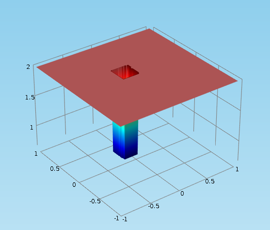

I have what I think is a very simple problem. I would like to define a 3D geometry from a JPEG/PNG image.
What I have tried., reading the forum as well as examples such as Mount St Helen, Rock Fracture and a few others.
What I do at the moment is;

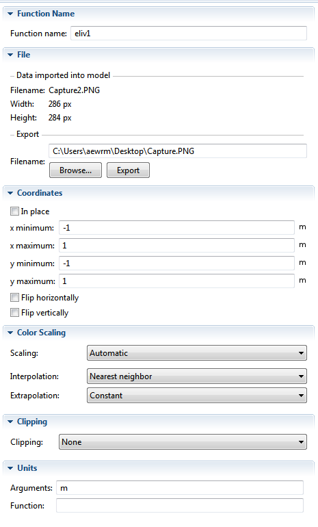

1) create an image in the definitions.

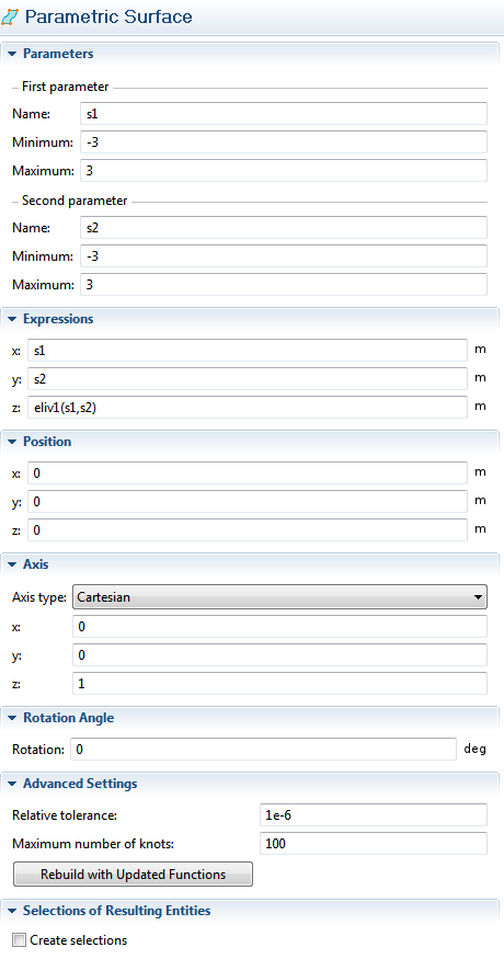

2) create a parametric surface in the geometry (I have included screen shots to illustrate).
However, I do not appear to be able to generate the surface at all. Have I done something silly?!

I think I may have solved the problem, kind of.
The issue was resolved by defining the image in Global Definitions not the Model Definitions. Once I did that the image and the Parametric Surface worked.
