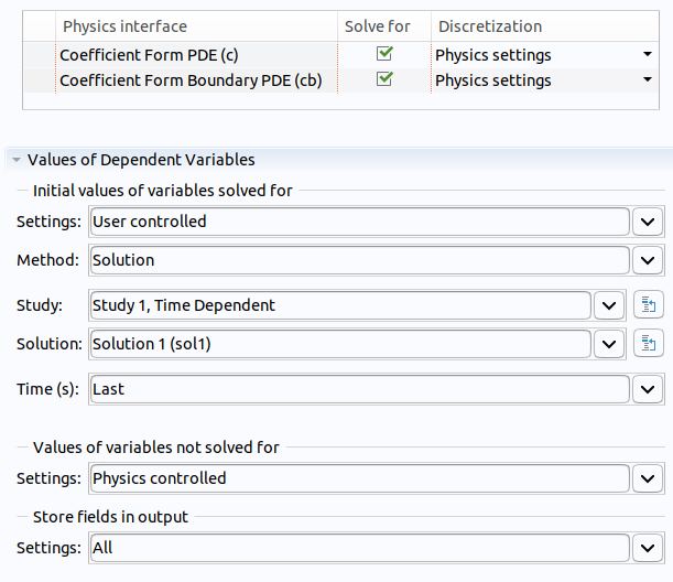

I'm having a problem with the following. I use comsol to solve two coupled differential equations for the two concentrations of the system over time. At some point in time(let's call it T) I want to increase the timestep drastically and my idea was to make the simulation from times 0 to T with the small time step in Study1 and to use the calculated concentrations from Study1 at time T for the second study as an initial condition in which the timestep is now really big. For one of the two concentrations that works fine - the initial condition is the correct one but for the second concentration comsol chooses 0 instead of the solution from Study1. A picture of my approach is inserted below. Has anyone faced a similar problem or knows how to solve it?
