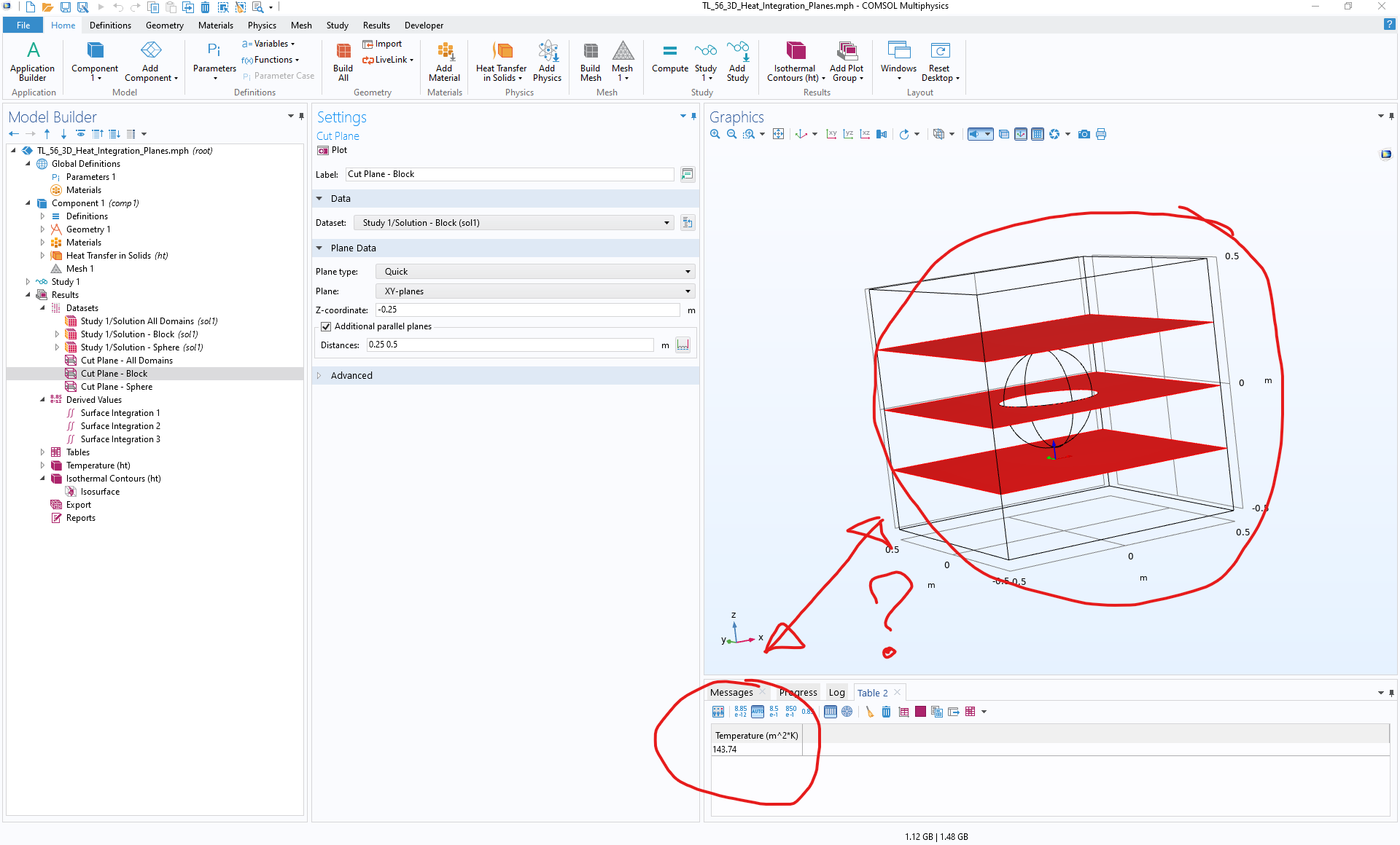

Hello everyone,
I was wondering if there was a way to obtain the integrals of a series of cut planes (created though the "Additional parallel planes" option"). My problem is illustrated in the attached screenshot where you can see a series of 3 cut planes, but COMSOL only outputs a single value when asked to integrate over these cut planes. I could always define independant cut planes, but then 1) the results would not be stored in a single table and 2) it would become extremely tedious if I needed to repeat the process like 20 times or more.
I already searched the forum and it seems that the answer did exist at one point, but now it leads to a broken link.
Please tell me if you don't understand my issue. I feel like I'm not being clear enough in my explanation (english is not my first language btw), because COMSOL Support were unable to give me a satisfactory answer.
