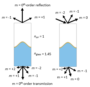

Dear All I am pretty new to COMSOL and I am working on sinusoidal grating surface. I want to simulate the surface as shown in the attached image. Kindly tell me how to build such kind of surface by using COMSOL geomtry?

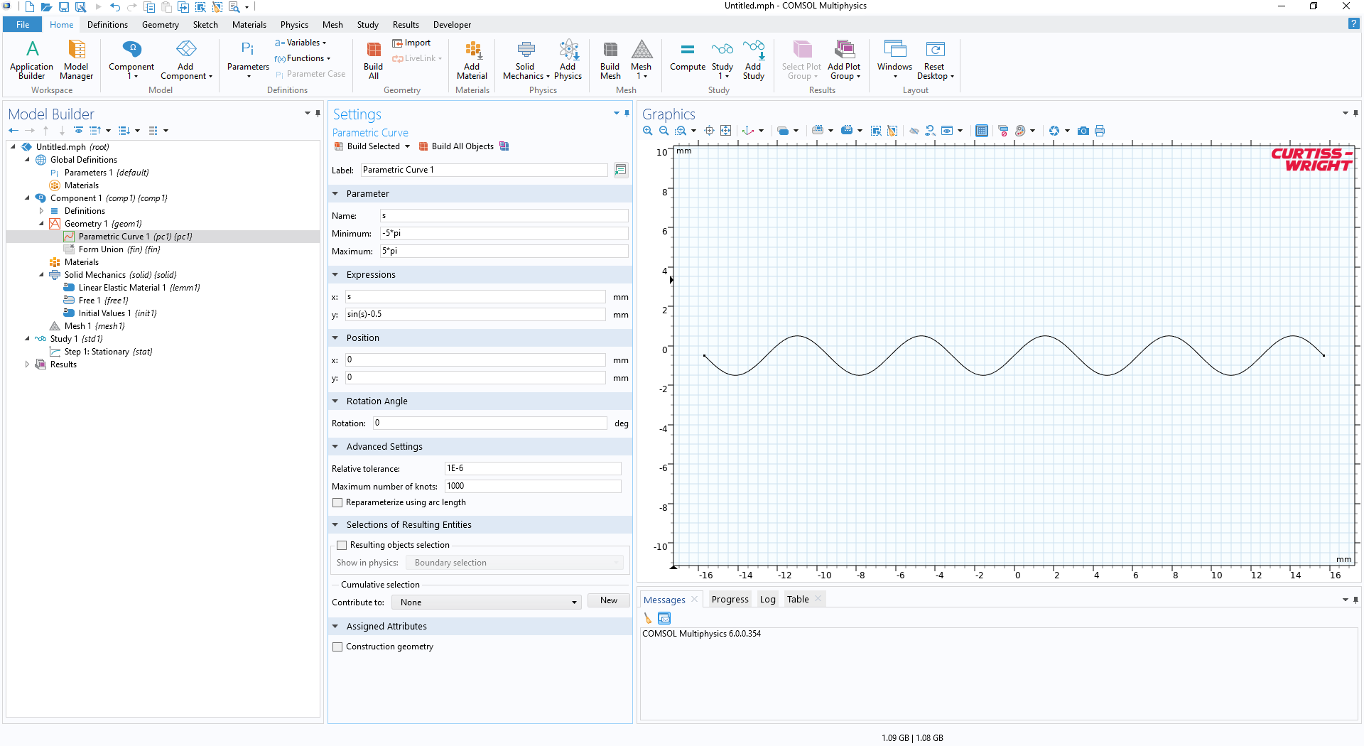

Use the parametric curve, found under "more primitives" when right clicking the Geometry node.
You can scale it accordingly...
