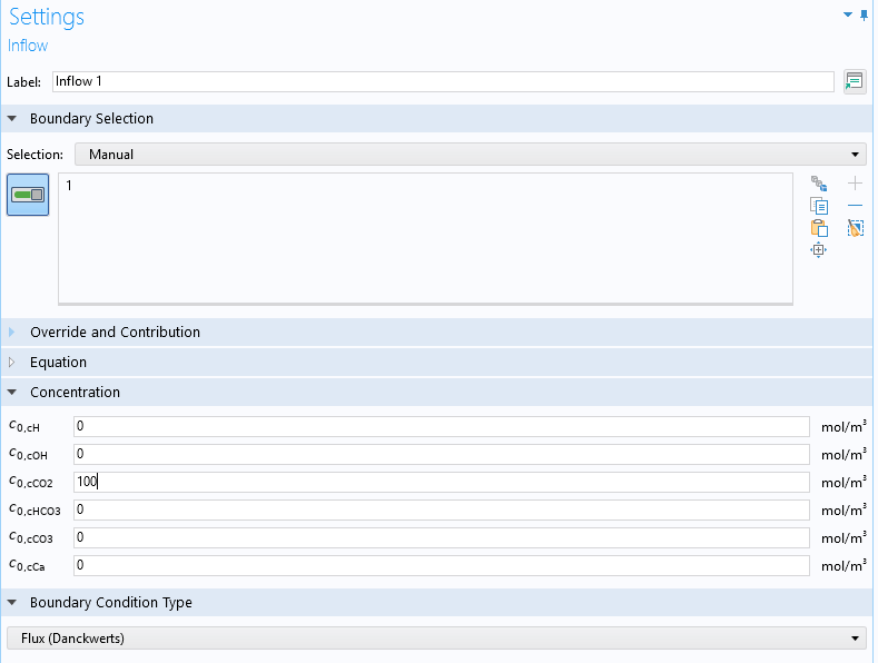

the boundary conditions are "inflow" at the inlet where I inject CO2 with 100 mol/m^3 and “No flux” condition at the outlet (advection not included). I have a constant velocity of 1e-8 m/s and diffusion coefficient for all the species is equal to 1e-9 m^2/s. (No adsorption or dispersion) .

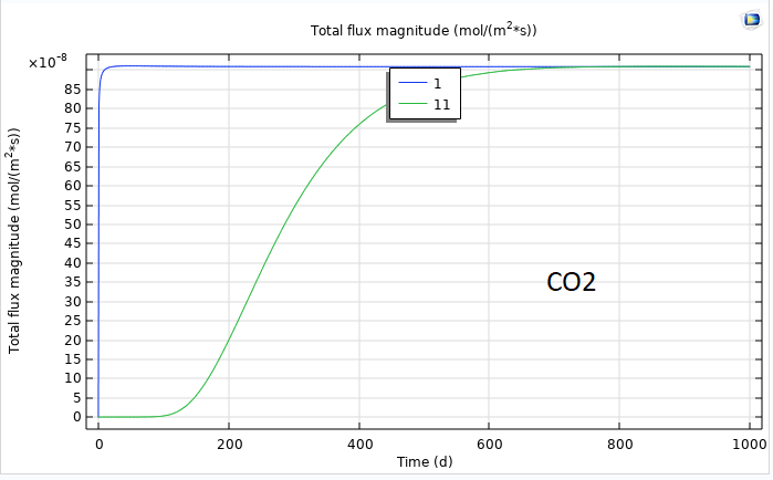

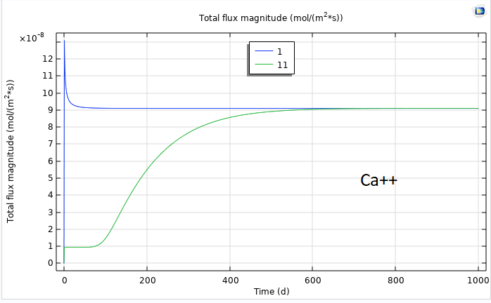

When I run the model I get satisfactory results. **The only problem is, when I check the total fluxes for different species at the inlet I get a non-zero value. In rules as I am injecting only CO2 I should not get any other inflows. **

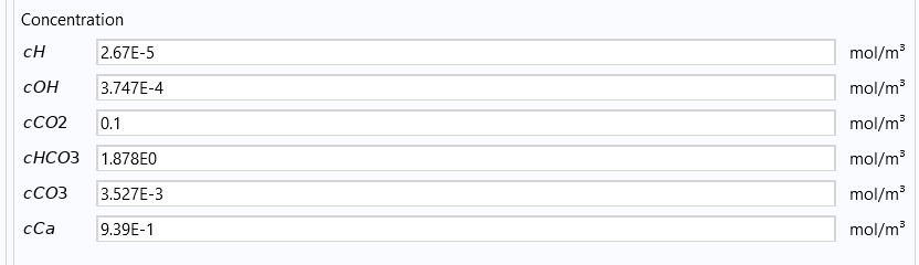

I have attached the initial values and the total fluxes for CO2 and Ca++ at the inlet. ‘Line 1’ is for inlet and ‘Line 11’ is for outlet.
