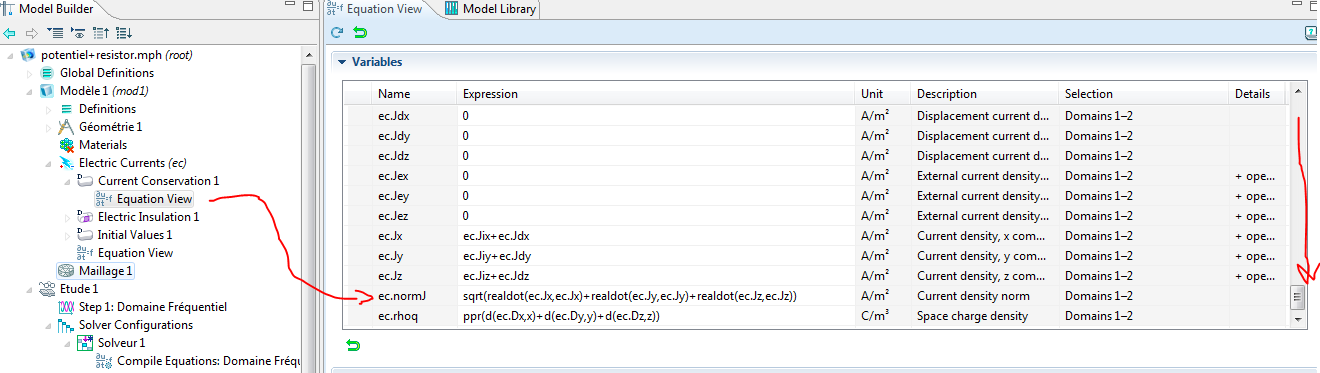

turn on the equation view (Options preferences) and look at the definition of the COMSOL internal variables, in this cas it is the norm (sqrt(Jx^2+Jy^2+Jz^2)) of the current density, the formula is "complex compliant" by the "realdot()" operator that is just there to correctly get the scalar value for complex current densities (typically AC cases)

I find it nicely in my 4.3 ;)
