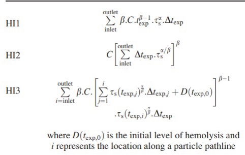

Hi, I really need your help in solving this equation that i have attached with this query. I am trying to solve for the hemolysis index of blood in a centrifugal blood pump. I am unable to understand how to solve for the exposure time of a blood particle along a pathline at a particular point of high shear stress. The values of alpha, beta and C are known.
