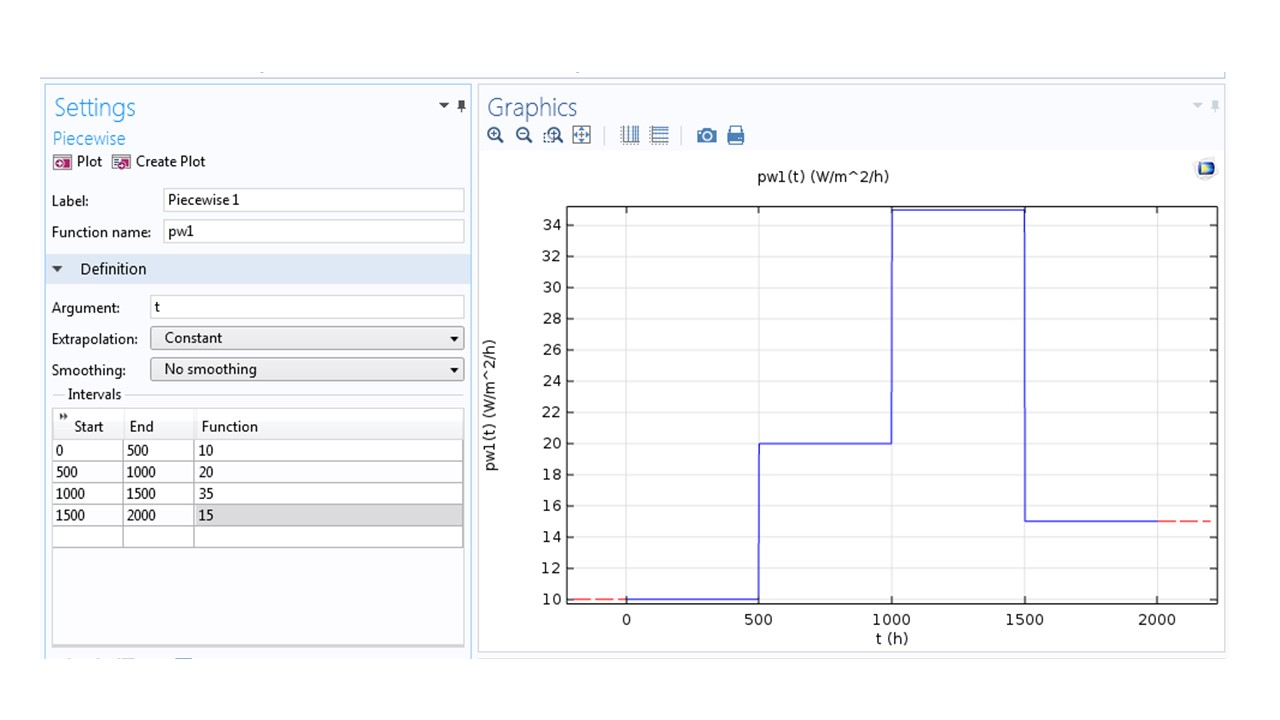

I have a similar problem. I have to set my convective heat flux depending how much time as passed.
For example;
Time (s) 0-500 set h=10
Time 501-1000 set h=20
Time 1001-1500 set h=35
Time 1501-2000 set h=15
How do I covert this into a IF statement to insert into the "Convective heat flux" field ?

Make a piecewise function, say pw1, and call it then pw1(t). See attachment.
Lasse
Hi Make a piecewise function, say pw1, and call it then pw1(t). See attachment. Lasse

I have done the piecewise function, but how are you plotting that graph with h as a function of t?
When I plot the graph I don't get any labels at all.

The function set-up window (my attachment) asks for the units of the argument and the function. You must fill in them properly.

Ok, I got it now, thanks for all the help.
