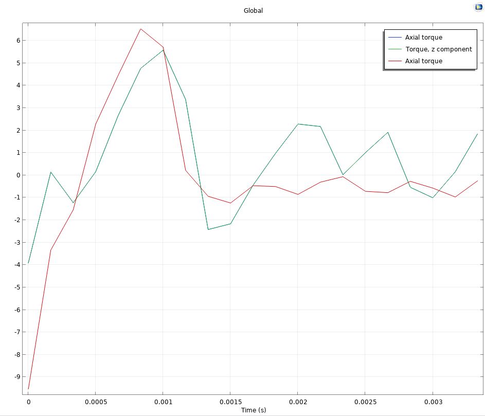

The attached image is of the torque when supplying no current to the coils and rotating the rotor with 3000 rpm through a rotating mesh. The green line is the torque from the force calculation and the red line is from Arkkio.
The force calculation is defined over the domain of the rotor and half of the airgap (closest to the rotor.
The Arkkio torque domains are both halfs of the airgap, separated with a boundary pair with continuity.

without knowing the details of your design, as this is a PMSM design with permanent magnets, shouldn't you expect some cogging torque due to the permanent field?
Cheers Edgar

I agree with you that some cogging torque should be expected. However, a mean of 9 Nm (from Arkkio) of cogging torque with no current seems to be to much for me. The motor is approximately only 100mm long with a radius of 40 mm.

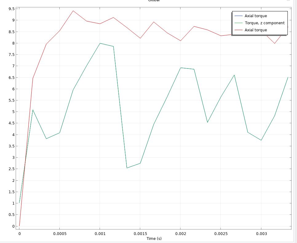

If I apply a sinosoidal 3-phase curent to the coils I get a reduction in Torque, compared to the zero-current case.
Attached is the torque results for a run with 100A peak current supplied. This run is also at 3000 RPM.
Could you think of anything that I could have done wrong or missed while building the model that would result in such results? I know that it is very hard to answer without seeing the model.
