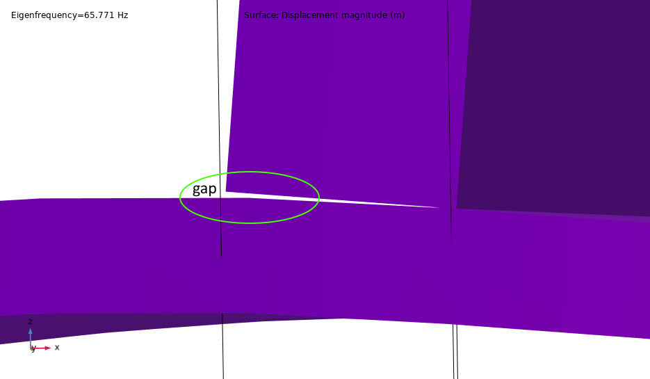

I have a fully-solid model in component1. Its eigenfrequency results are used as a reference for the shell models.
The shell model in component2 is based on the solid. Boundaries are obtained using extract node. The eigenfrequency results of this shell mode are very different from the reference solid one.
Another shell model is created in component3. The vertical boundary is displaced intentionally in z-direction for 0.2 mm. Edge to edge connector node is then used to connect the vertical and horizonal boundaries. Eigenfrequency results of this second shell mode are closer to the reference.
If edge to boundary node is added to the first shell model (comp2), the result is improved. But it is still not as good as that of the second shell model.
Is there anything wrong in the first shell model? I suppose the two extracted boundaries are connected automatically by form union. We don't need to do any manual connection as that is done in the second shell model. Is the edge to edge/boundary connection necessary?
