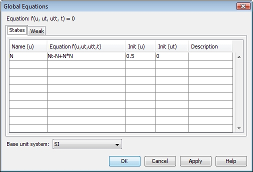

Posted:
1 decade ago
Nov 16, 2012, 12:19 p.m. EST
Hello, Subha,
It's easy. Follow these steps:
1. Open any space dimension, for instance 1D (you will use no dimension at all, as you only will solve ordinary differential equations).
2. Open any physics with time dependent analysis, for instance:
New > COMSOL Mult. > PDE Modes > PDE, Coefficient Form > Time-dependent analysis > OK
This is only to tell COMSOL to start with a time-dependent analysis, although you are not using this physics later.
3. Draw any geometry, for instance only a point.
4. Go to menu: Physics > Global Equations: write here your dependent variable (1st field), its ord. differential equation (2nd field) and its initial values (fields 3rd and 4th).
5. In Menu: Solve > Solve Manager > Solve For: select only your ODE (not PDE ...)
6. In Menu: Solve > Solver Parameters > Time Dependent > General: set the times for which you want to solve.
7. Solve.
8. In Menu: Postprocessing > Global Variables Plot: select your variable (for instance u) and slect OK.
I hope this helps you.
Jesus.

Posted:
1 decade ago
Nov 16, 2012, 12:56 p.m. EST
hi
suppose my equation is logistic growth equation
1. ok
2.ok
3. ok
4. go to physics menu > global equation : field 1 name(i wrote, N), field 2 equation (i wrote, dN/dt= N(1-N)), field 3 init N (i wote, 0.5) , field 4 init Nt (i wrote, 0)
is it ok?
5. In Menu: Solve > Solve Manager > Solve For: select only your ODE (not PDE ...)....... note you did not tell, with out solve, in solve manager window what to click after slecting only ode, solve? cancl? apply? ok? help? what to click here at end?
6. In Menu: Solve > Solver Parameters > Time Dependent > General: set the times for which you want to solve. this window does not contain any solve button??
7. Solve.
8. In Menu: Postprocessing > Global Variables Plot: select your variable (for instance u) and slect OK. note i cannot see any field which asks about variable? vaiable dependent or independent?
please reply....
hi
1. ok
2.ok
3. ok
is it ok?
7. Solve.
please reply....
Posted:
1 decade ago
Nov 16, 2012, 1:15 p.m. EST
In step 4, correct your equation: it should be
Nt-N+N*N
, as Nt means derivative w.r.t. time and you have to enter the expression which is null-valued.
In step 5: after selecting only ODE, press OK.
In step 6: select your times and press OK.
Step 7. Press the SOLVE button (symbol "="), or in Menu > Solve > Solve Problem.
Try these steps, please.
Jesus.
Nt-N+N*N
Jesus.
Posted:
1 decade ago
Nov 16, 2012, 1:34 p.m. EST
hi
Nt-N+N*N
it gives error
duplicate variable
N
Nt
Ntt
n
Nt
Ntt
variables are repeated?
for step 4
Name (u) equation f(u,ut,utt,, t) init (u) init (ut)
N Nt - N + N*N 0.5 ?
please correct if wrong.
regards
hi
Nt-N+N*N
it gives error
duplicate variable
N
Nt
Ntt
n
Nt
Ntt
for step 4
regards
Posted:
1 decade ago
Nov 16, 2012, 1:40 p.m. EST
See the image attached.
Good weekend.
Jesus
Good weekend.
Jesus

hi
the similar i did. but error duplicate variables. how to handle it?
tc
hi
tc
Posted:
1 decade ago
Nov 17, 2012, 1:39 a.m. EST
Sir how can i learn usinf comsol efficiently. for me teacher is better is than book. do u give online classes?
Posted:
1 decade ago
Nov 17, 2012, 2:09 a.m. EST
her is the error i m haveing
Error: 6164
Duplicate variable name.
varaible:N
varaible:Nt
varaible:Ntt
varaible:N
varaible:Nt
varaible:Ntt
how to handle it.
note : in draw section: for my equation dN/dt=N(1-N), i drew a line from 0 - 1
this represents length of independent varable t . then on page Solver parameter
field: Times= 0:0.001:1
field: Relative tolerance: 0.01, by default (should it remain the same)
field: Absolute tolerance: 0.0010 , by default (should it remain the same)
after this press OK?
please notify if i m wrong at some step.
regards
Error: 6164
varaible:N
varaible:Nt
varaible:Ntt
varaible:N
varaible:Nt
varaible:Ntt
how to handle it.
regards
Ivar KJELBERG
Posted:
1 decade ago
Nov 17, 2012, 4:44 a.m. EST
Duplicated variables means as stated: a variable has been defined several places.
Many variables are defined internally by COMSOL, so these names should not bre reused, at least not in a varaible declaration. In contrary to a Parameter, which can be overwritten later, one shall not declare a user variable name with a COMSOL name (at least that is my understanding)
You can degine Global varaible high up in the node tree, these are defined for any model, so are generally space variable independent
You can define local variabbles under each model in a file, these are either scalars, or fields depending on the model geoemtry, or time or ...
But in anycase names should be unique. In V4 (probably also v3) names are tagged as préfix in v4 and suffix in v3 such that one can define some exceptions above. As a local variable with one name can take different expressions for different entities (domains, subdomains/boundaries ...
To lear COMSOl its worth to take a few chapter of the user manual per day, in small doses, then t reapet the reading 2-3 times over a year, as at each reading you discover new things you didi think of during the first reading.
Comsol convention for doing math, and with their unified physics layers ontop is very nice, but needs some time to learn, even if I finally find it close to my math/physics teaching, once I have identified the correct links
