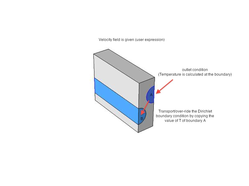

In the tutorial model of the HT transfer package called heat_exchanger_iso.mph, I would like to connect both pipes in a U-bend, but I prefer not to solve N-S.
I would like to keep the same geometry of the tutorial but with a much larger length of the pipes (extrusion). Then I would like to have the temperture calculated "outlet" condition of one pipe as the tthe inlet of the other. The velocity field (quadratic) continues to be the original. Is it possible ?
Thank you.
Thank you.
