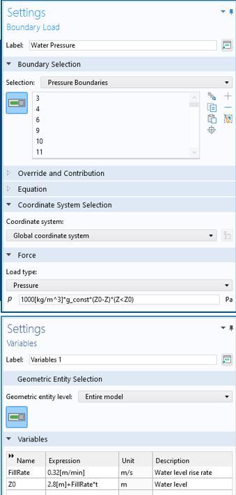

Hi, i would like to create a load that is varying with depth, however i cannot figure out how to do this in solid mechanics. The sort you would expect to see with water.

Attached is an example where the water level is even rising with time.
