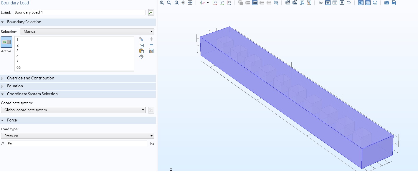

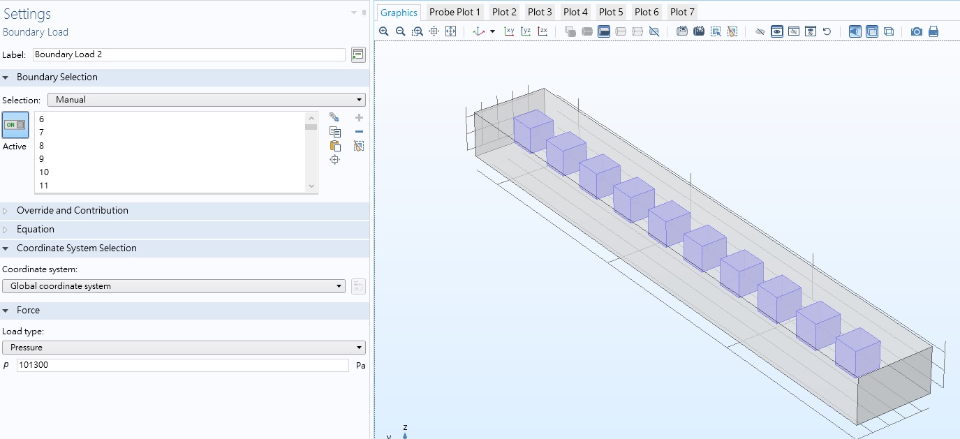

Boundary Load:
Inner chamber surface: 101300 Pa
Outer surface: Pn (Parameter sweep from 0 to 101300 Pa) (The load is illustrated in the attachment figure below.)

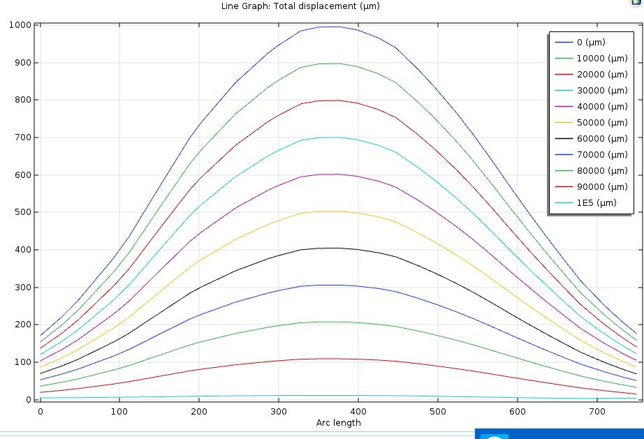

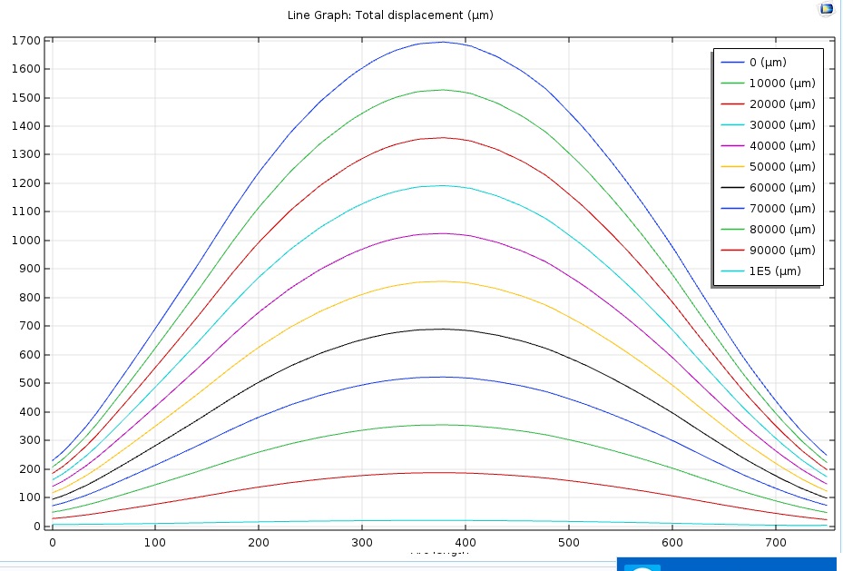

Problem:
When I mesh the geometry finer ( from normal to finer), the membrane deformation increase, when I mesh the geometry coarser, the membrane deformation decrease. Shouldn't it be the same deformation no matter what type of mesh level?
I was wondering why the simulation results turned out like this. Or are there any other methods to apply the air pressure load to simulate the vacuum variation in this situation?
