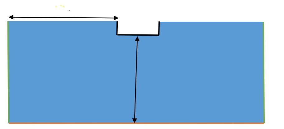

I am trying to simulate the wave propagation phenomena in physics of the Solid Mechanic (Elastic Wave) using Time Dependent study.
Linear elastic should be considered as the Material model.
The main challenge is the getting rid of reflecting wave due to impinging the boundaries.
there is some information:
1) PML no effect; it seems it could only be used in the frequency domain.
2) Infinite elements have no effect.
3) Low reflecting BC have some effect. Still, there is reflection, but it is better than PML and infinite elements.
The low-reflecting boundary is ideal only for normal incidence, but it also does a decent job for oblique waves if the angle of incidence is not too large. (By Henrik Sönnerlind)
Can I do this while there is not any reflection?!!!! is there any experience
