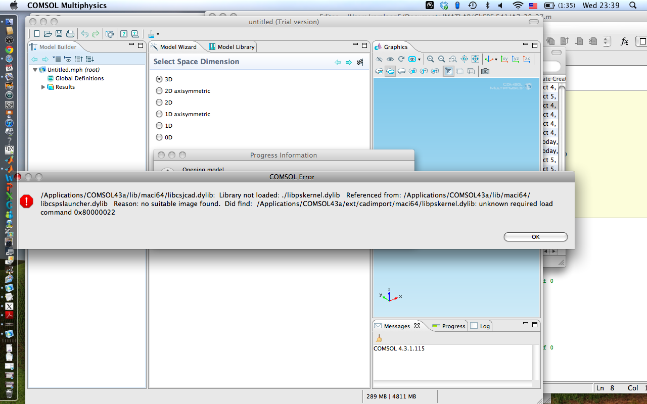

After installing 4.3a, whenever I open most files (or try to at least), I get the following error in a pop-up window:

Let's start with what type of computer, what operating system, what version of the operating system, memory in your machine, and anything else you might know about your computer (graphics card. etc.).
