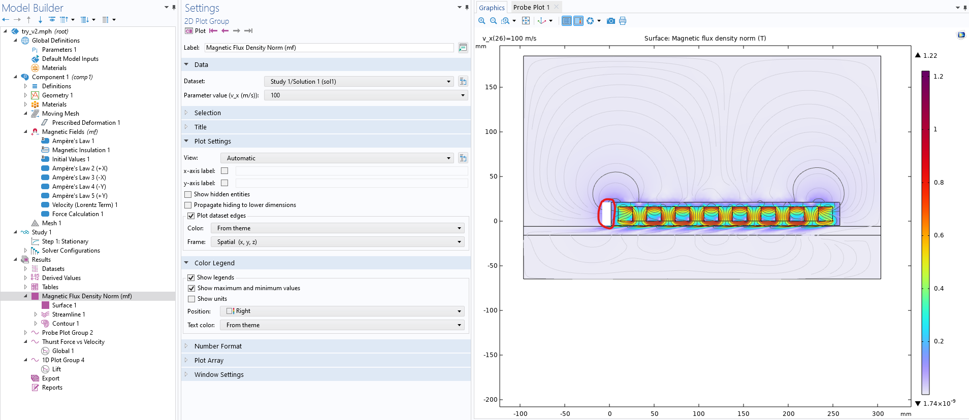

Using the magnetic field interface, we moved the magnetic field source domain, consisting of permanent magnets on the aluminum rail, in the positive x direction in the solution area, using a moving mesh. However, there is a white space left on the left side of the solution area. We would be very grateful if you could help us solve this problem.
