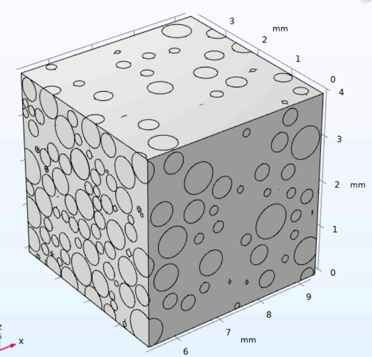

Hello Everyone,
I am doing a research on 2D and 3D porous media and in a part of this study I need to assess elastic properties of these models. I preferbably looking for sound velocity, Young modulus or any other elastic properties of these models. Following shows a similar model to my media.
What is your suggestion in terms of physics, study type and boundary conditions?
Thank you in advance for your help

Hello Ali,
As a starting point, see my response in this recent thread on how to compute effective properties of inhomogeneous materials.
Jeff Hiller
Hello Ali, As a starting point, see my response in [this recent thread](https://www.comsol.com/forum/thread/331111/thermal-conductivity-of-nanocomposite-matrix-particles?last=2023-10-23T13:39:43Z) on how to compute effective properties of inhomogeneous materials. Best, Jeff
