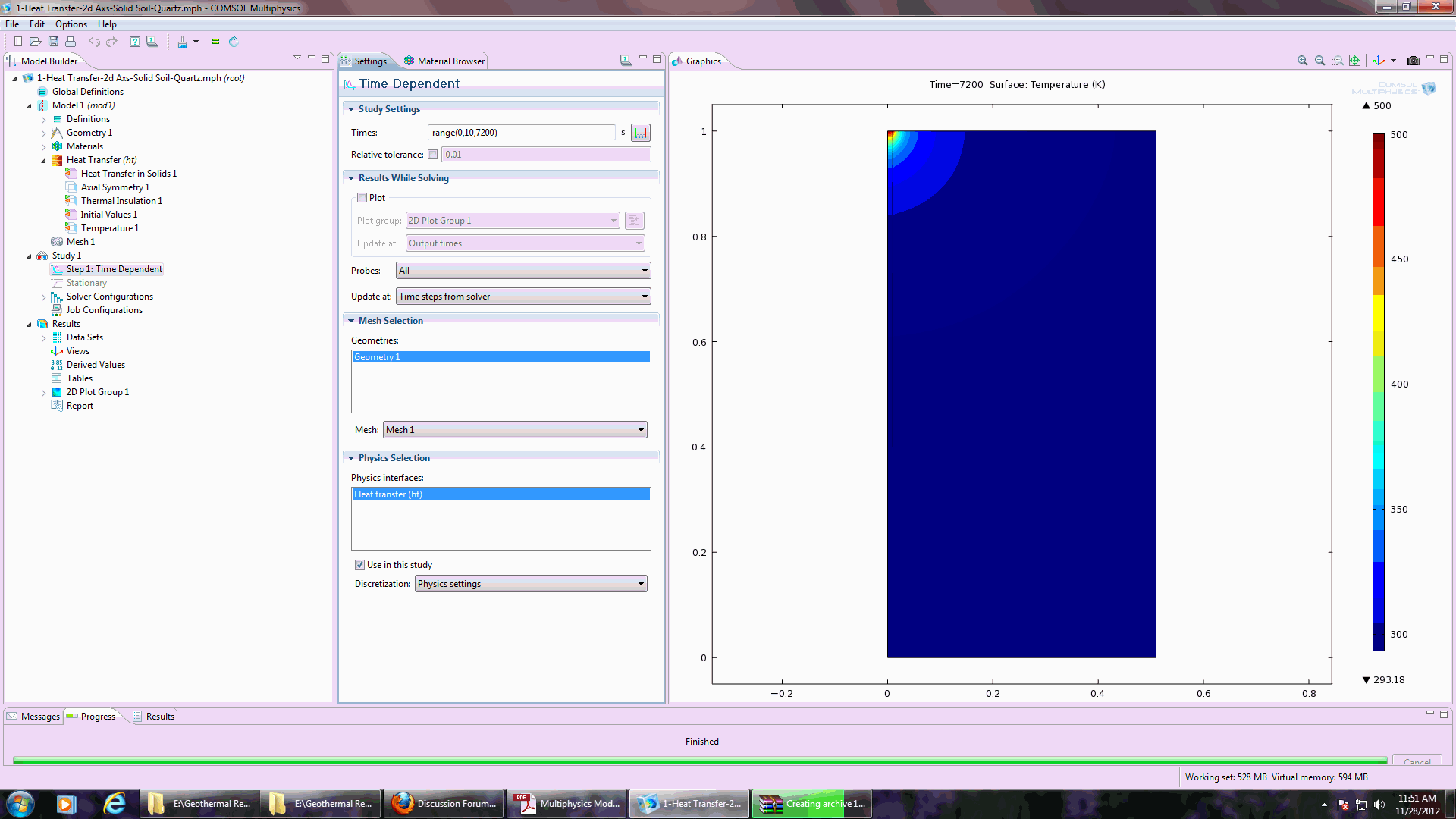

I am a comsol user and I want to have a 2d axisymmetric model. In my model, I have a soil sample that I put a steel bar in the soil. I want to heat the steel bar with a constant temperature 500(k) and then wait for 6 hours to see that how the heat will be conducted in the soil. The problem that I have is that after simulation, I do not know why I could not have good results. The heat will just be conducted at the top of the model, and the rest of the model will remain unaffected. You can see my model in attached file.So if it possible, I want to know that what do I need to do to solve this problem? Where is my mistake?

Based on the figure you attached it seems that you are only applying the 500K temperature at the top surface and not along the full bar.
Nagi Elabbasi
Veryst Engineering
Based on the figure you attached it seems that you are only applying the 500K temperature at the top surface and not along the full bar. Nagi Elabbasi Veryst Engineering
