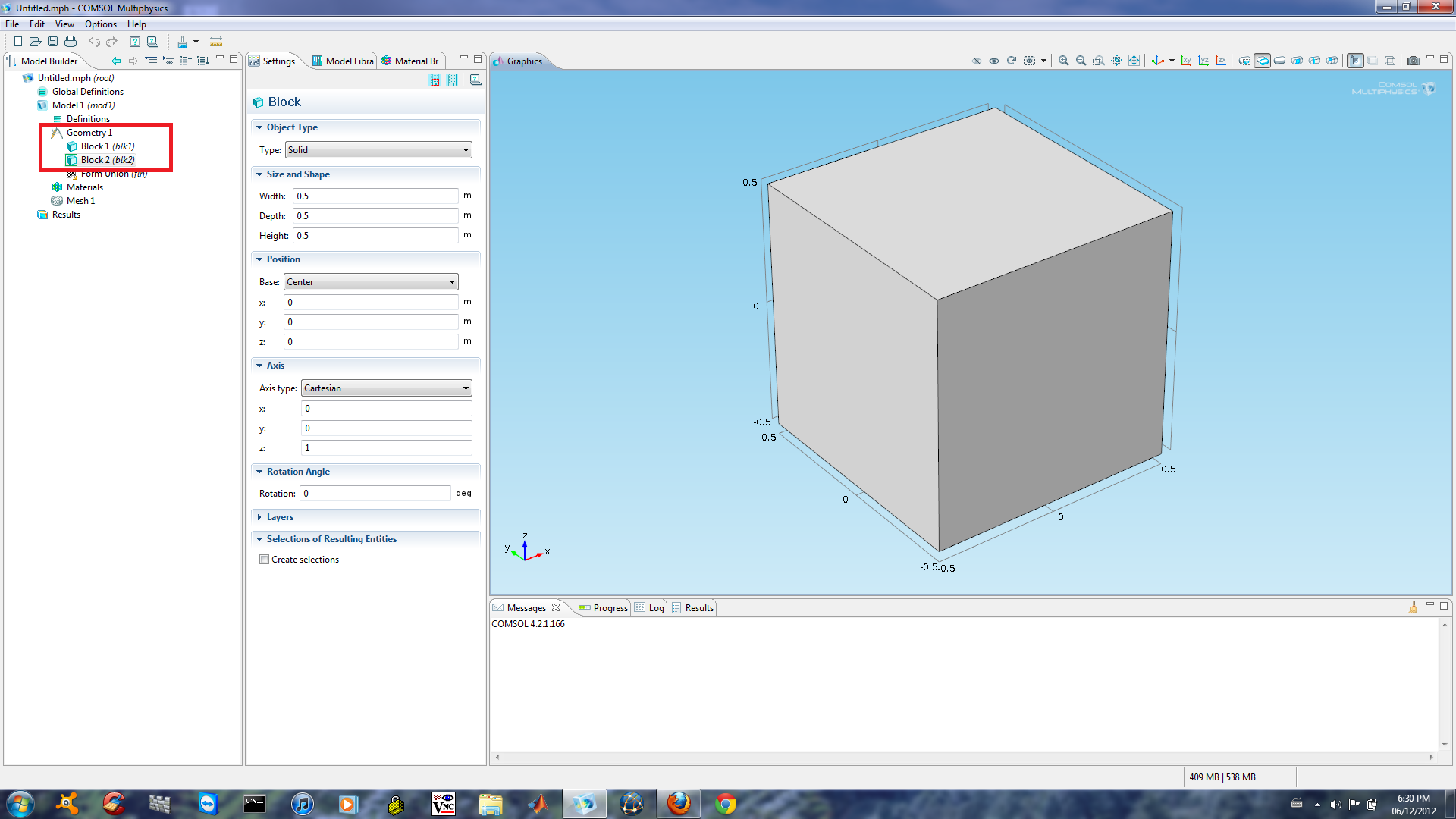

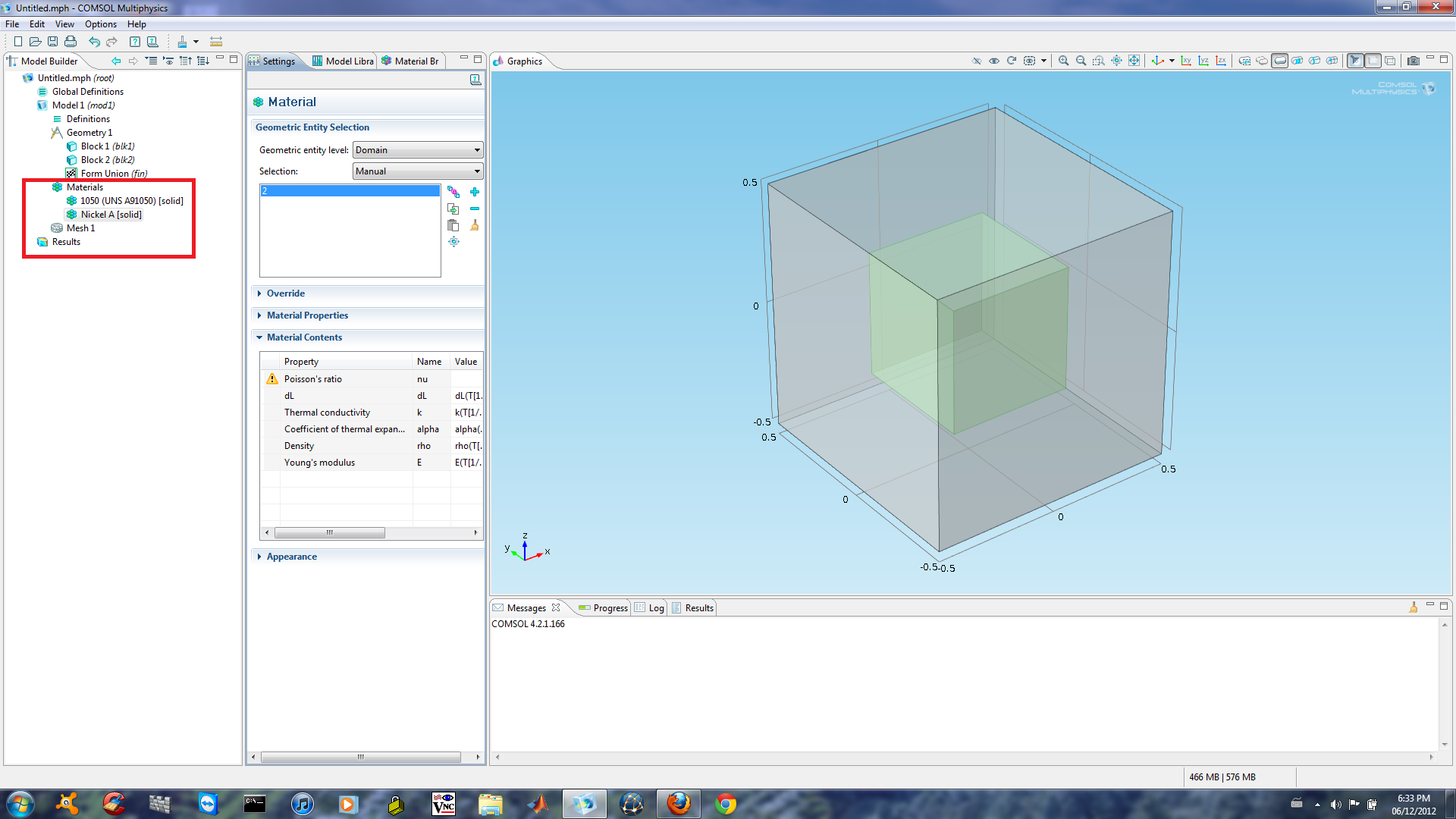

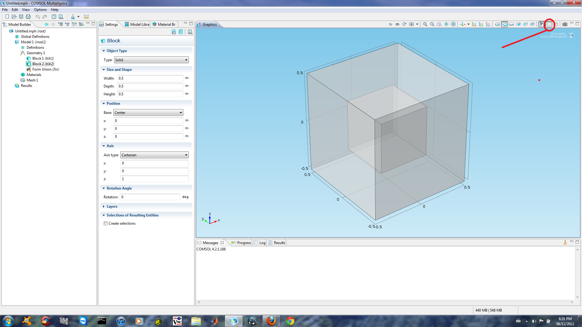

attached find the image files of the model. First create two blocks of different size (_1), then go to transparent option (_2), go to material and select the materials that you want and define them under domains selecting any domain (block) you want (_3).
cheers
Mayur
Hi, attached find the image files of the model. First create two blocks of different size (_1), then go to transparent option (_2), go to material and select the materials that you want and define them under domains selecting any domain (block) you want (_3). cheers Mayur

Thanks Mayur,
it worked, but doing this I have four faces of inside cube of type " not applicable". Can I apply any boundary condition on that face?
Thanks Mayur, it worked, but doing this I have four faces of inside cube of type " not applicable". Can I apply any boundary condition on that face?

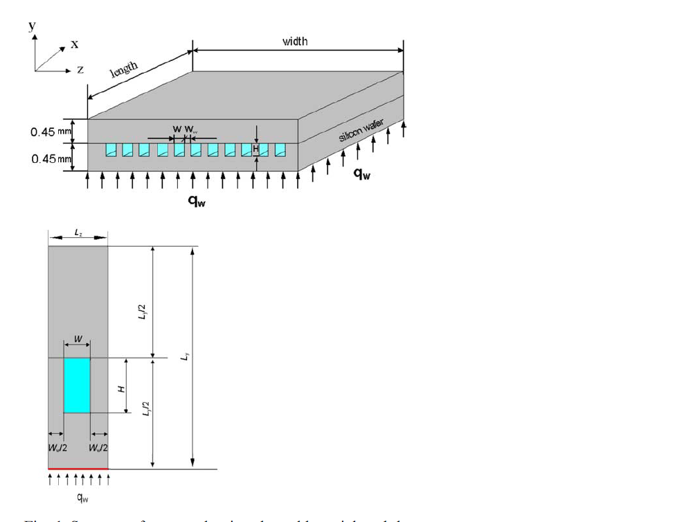

are you trying to replicate the result published in International Journal of Heat and Mass Transfer 47 (2004) 4215–423?
Posted: 1 decade ago Dec 7, 2012, 8:59 p.m. EST
Yes, I am trying to use this geometry for my practice.
Posted: 1 decade ago Dec 7, 2012, 9:00 p.m. EST
I mean same geometry of International Journal of Heat and Mass Transfer 47 (2004) 4215–423?
Posted: 1 decade ago Dec 7, 2012, 9:12 p.m. EST
okay, after looking at this paper, it seems water is flowing through the cyan color channel (Fig 1 and 2 in paper), actually you tried exactly opposite to what is given in the paper.
