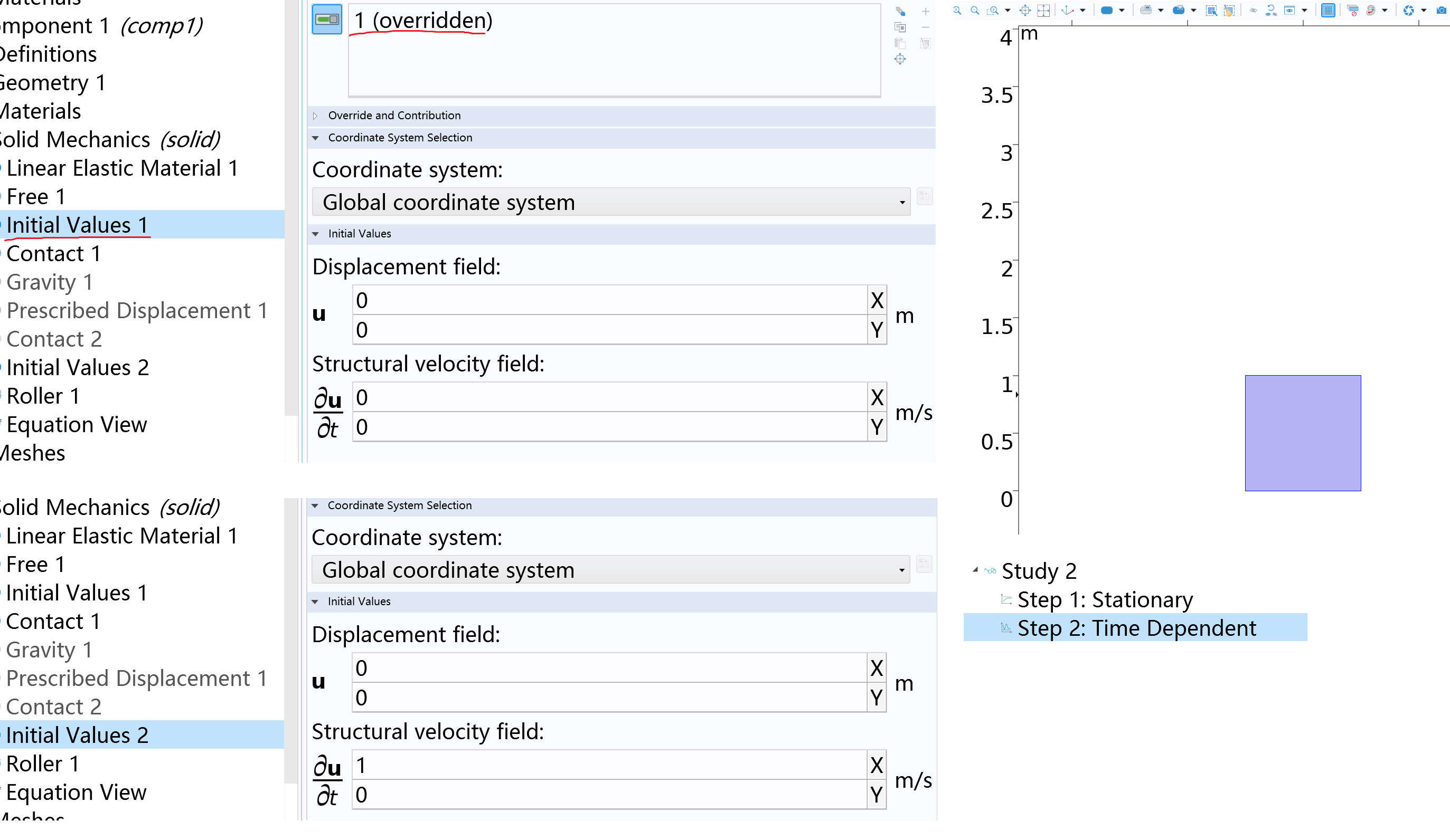

Posted: 2 years ago Apr 2, 2024, 10:29 p.m. EDT
Thank you Dr Sönnerlind. I strictly follow your advice (In step 1, disable the second Initial Condition node under Modify model configuration for study step) as in the attached figure. But the block never moves. It seems that the second initial condition isn't applied at all by the software.

Posted: 2 years ago Apr 8, 2024, 5:29 a.m. EDT
That is correct. You need to take initial values from User Controlled -> Initial Expression in the second study. The default is to use results from the previous study as initial conditions.

Posted: 2 years ago Apr 9, 2024, 10:11 a.m. EDT
Then in such a case, the solution of the current step has nothing to do with the solution of the preceding step under the same study? This is equivalent to putting these steps in separate studies?
>That is correct. You need to take initial values from *User Controlled* -> *Initial Expression* in the second study. The default is to use results from the previous study as initial conditions. Then in such a case, the solution of the current step has nothing to do with the solution of the preceding step under the same study? This is equivalent to putting these steps in separate studies?
Posted: 2 years ago Apr 10, 2024, 3:50 a.m. EDT
In most cases, it will be the same, yes. There are some subtle exceptions, for example if you don't solve for the same degrees of freedom in both study steps. But by making the appropriate settings, you can obtain the same results using either two studies or two study steps within one study. it is more a matter of convenience. Study steps within one study are mainly intended for cases where there is a chain of solutions that depend on each other.
