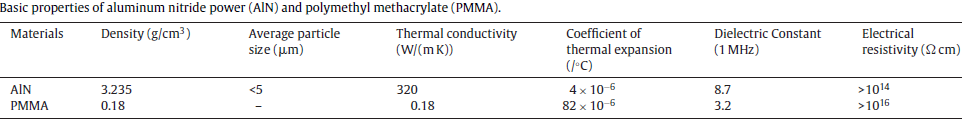

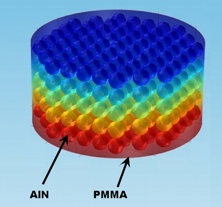

i need to calculate thermal conductivity for various volume fraction of ALN with PMMA. In that paper they mentioned about When the sample is given a heat power,the direction of heat transfer is lower to upper of the cylinder (PMMA).
PMMA they used as cylindrical shape and ALN they specified as sphere. Could you help me how to get the thermal conductivity from input file.(i had attached my input file with this message).

Then I would set a constant temperature T0 at one face (upper or lower) of the cylinder, set a constant power of 1[W] on the lower surface, and run a stationary study, even with parameters to change Lcyl, Rcyl, and/or Rsph and plot out
Average T on the Q=1[W] surface and deduce (with correct units) the result:
k_eq = 1[W] / Lcyl / (Aveop1(T)-T0)
To validate, you couls check that when you put all material PMMA and all ALN and run the same study you get k_eq = k_pmma and keq=k_aln respectively, and that k_aln>k_eq>k_pmma
even you should expect to have some rule of the type 1/k_eq = Const1/k_pmma+Const2/k_aln where Const1 and 2 are related to the geometry sizes

OK but then you have 2 approaches, your method with one lumped sphere might be sovled by a FEM model as you built it,
but if you say you are mixing two materials in a homogenious way then you could probably use a rule of the type
k_eq = (1-pr_aln) * k_pmma + pr_aln * k_aln (for parallel conductances, and the "1/" for serial conductances)
where pr_aln is therelative material volumic ratio of the ALN , but it all depends on what you want to show
You could apply similar formulas for rho, and Cp
make it a try, and perhaps take a look at the COMSOL approach for two mixed material in i.e. porous matrerial examples
Have you checked articles like:
"Numerical analysis of effective thermal conductivity of mixed solid materials" Zhang Yinping, Liang Xingang, Materials & Design, Volume 16, Issue 2, 1995, Pages 91–95, the first that showed up on a quick google search ;)
or www.owlnet.rice.edu/~ceng402/proj02/sleung/finalproject.htm
or www.ias.ac.in/matersci/bmsaug2004/373.pdf
Obviously if your material is not only mixing, but also chemically reacting, you wil get different results, and the simple formulas above will no longer hold, in details, but then you need also to adapt your FEM with other material properties
I'm not sure there is anything "wrong" apart that I would not define any boundary layer, just leave the "domains"
Now you have 3 variables: radius of sphere, radius of cylinder and height of cylinder, while the other formulas from the articles, are related to a sphere inside (and same "centre" of) a cube hence only two variables cube length and sphere radius.
To check the formula you need to reproduce exactly the same conditions, it works rather well for a stationary case (cube and sphere) see attached model (4.3a) but then there are two remarks, first for dynamics none of these formulas (and only a correct FEM model) will give you the right values, and what about the BC you use, I have tried both fixed T on bottom, constant average power on top, and fixed T on top and on bottom, with a fixed DT. for the stead state conductance one get the same average value, but looking closer on the heat flux values, or the T variation on the constant flux side one see quite some variations in flux to get the same constant temperature.
Ideally I should set periodic T values at the two/four vertical Boundaries, in addition to isolation/symmetry but with a regular mesh these conditions should be rather equivalent anyhow
My model has a 2D (cylinder in cube), and 3D true sphere in cube model, only the later agrees well with the formula
For your case you need to adapt the cylinder radius to the cylinder height and then adapt the values to your volume fraction
