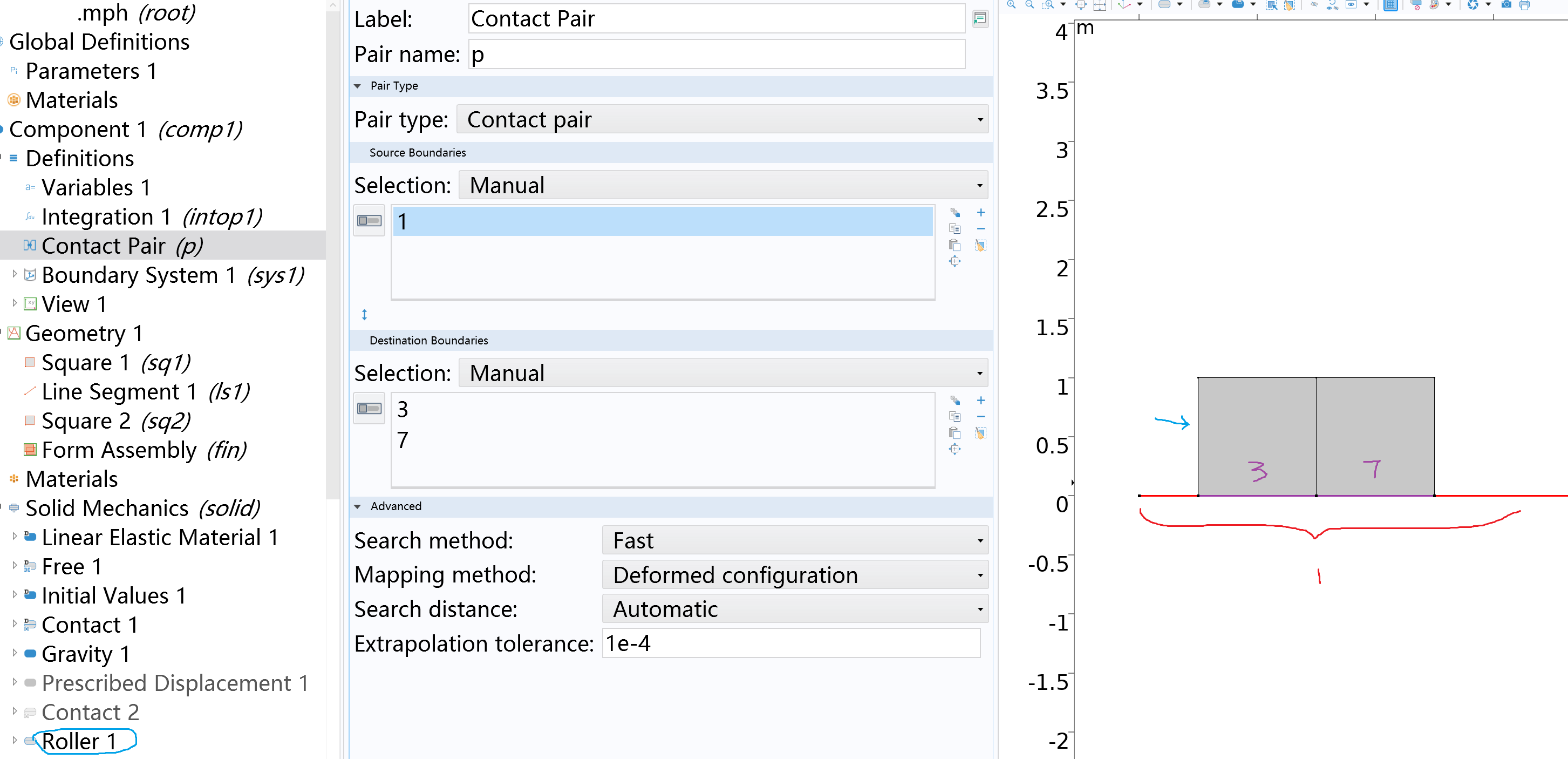

slider in contact with a rigid line
Posted Apr 1, 2024, 1:47 a.m. EDT 0 Replies
The slider in the figure has different elastic constants on the left and right parts. The two parts form the whole slider so they cannot separate or penetrate. Nor can they shear along the interior boundary. The slider as a downward gravity and a roller boundary condition on the left boundary. A stationary analysis fails and I wonder why? Should one do sth with the "form assembly"?
