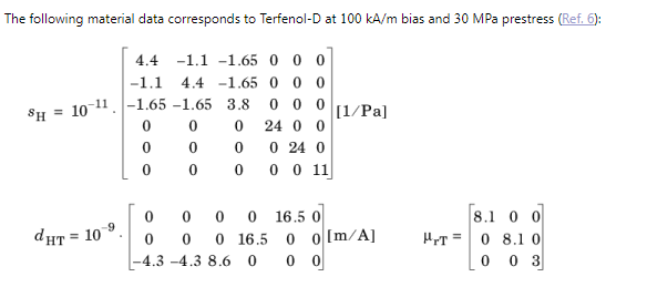

Well first i wanna say thanks, i will for sure take a look into that. But could i ask what do you mean with the solver is not defined?
Also where can i find the expression for Compliance matrix, coupling matrix? And Piezomagnetic coupling matrix, Voigt notation?

There wasn't any solver sequence, probably due to the missing piezomagnetic domain and the resulting error. COMSOL stopped before building the solver sequence.
Material data for magnetostriction is a difficult point. You can find data for the material used in the library example (a giant magnetostrictor like Terfenol, used for tranducers), but that is not valid for Iron. Iron and polycrystalline ferrous materials have a more complex magnetostrictive function. Also the current nonlinear magnetostrictive approach in COMSOL is not really suitable for materials like Iron, even if you had a magnetostrictive function. You may get a result but it is probably not correct.
I developed a method for the linear case with DC bias and a small AC perturbation, but this is not suitable for a transformer.

There wasn't any solver sequence, probably due to the missing piezomagnetic domain and the resulting error. COMSOL stopped before building the solver sequence. Material data for magnetostriction is a difficult point. You can find data for the material used in the library example (a giant magnetostrictor like Terfenol, used for tranducers), but that is not valid for Iron. Iron and polycrystalline ferrous materials have a more complex magnetostrictive function. Also the current nonlinear magnetostrictive approach in COMSOL is not really suitable for materials like Iron, even if you had a magnetostrictive function. You may get a result but it is probably not correct. I developed a method for the linear case with DC bias and a small AC perturbation, but this is not suitable for a transformer.
Posted: 12 months ago May 14, 2024, 9:43 a.m. EDT
Could i use another material for the core then to get it to work?

Do you have its coupling matrix?
Posted: 12 months ago May 14, 2024, 12:55 p.m. EDT
No, will have to research if its possible to find.
