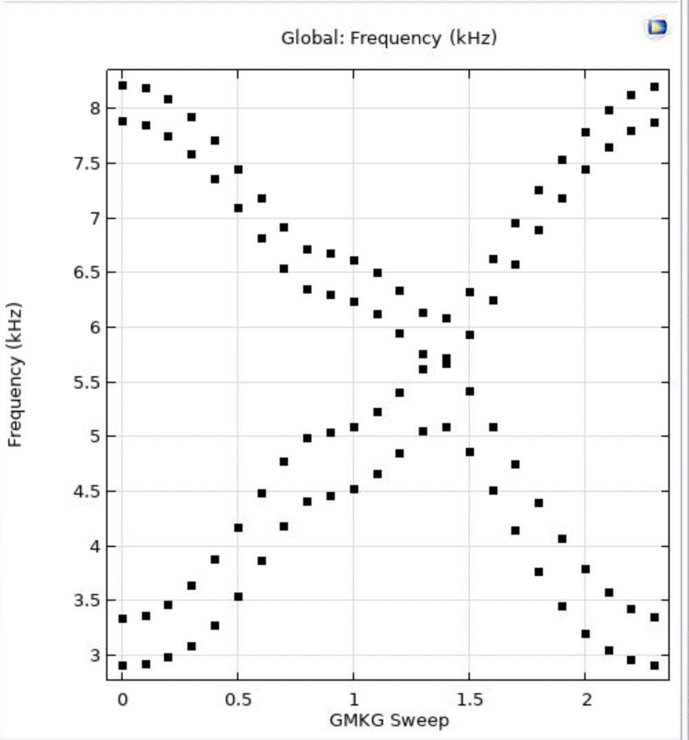

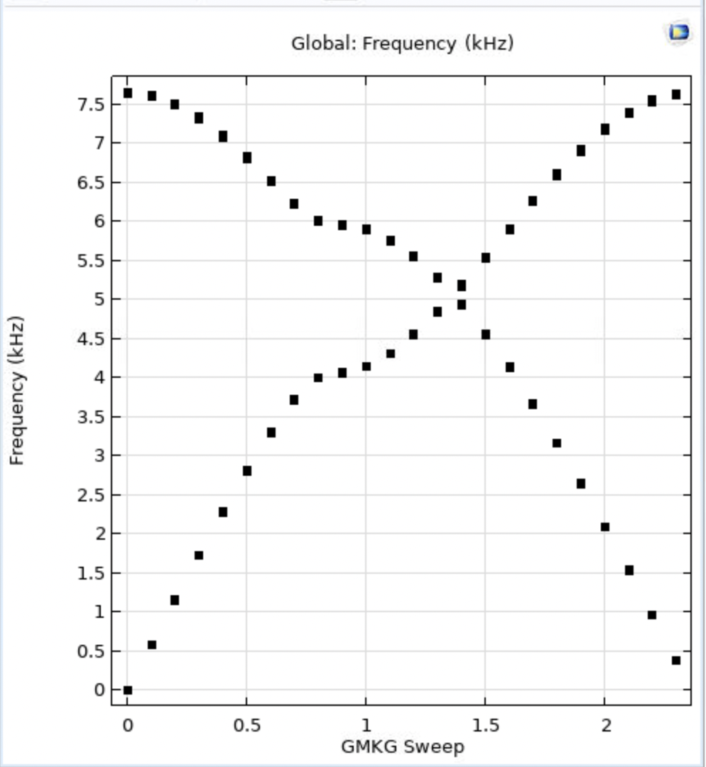

My issue currently is that when I have the wood interlayer membrane (labeled domain 3) under Solid Mechanics, the coupling between the two layers doesn't seem to register. I've attached two screenshots, showing what I expect (and get when I select the interlayer domain under Pressure Acoustics instead) vs. what I get (interlayer under Solid Mechanics). I thought that the Acoustic-Structure boundary would properly couple the two domains, but it doesn't seem to be operating as expected. I'm wondering if there's something wrong with my modeling strategy that is resulting in this issue.

If you solve the Eigenfrequency problem with Pressure Acoustics, Solid Mechanics, and Acoustic-Structure Boundary all enabled, you can compute the coupled natural frequencies and mode shapes. The Acoustic-Structure Boundary is showing (correctly) the boundaries for which the multiphysics is enforced.
It seems you are not getting an expected result - but this could be due to other issues instead of the multiphsyics coupling. For example, check the mesh - is this resolving the mode shape? It looks like the Young's modulus for American red oak is set to 1 Pa. Is this correct? This is very soft and will result in very slow wave speeds. Keep in mind that if you solve Domain 3 with Pressure Acoustics, along with a different physics assumption, it will utilize different material properites (speed of sound and density) compared to if the domain is solved with Solid Mechanics.
