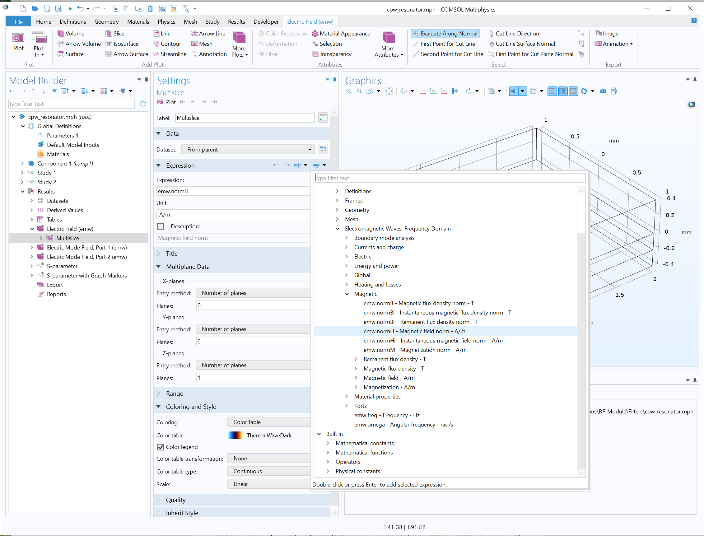

Also, if/wherever you may be plotting quanties like emw.Ex, emw.Ey, emw.Ez, or emw.normE, consider simply replacing those by emw.Hx, emw.Hy, emw.Hz, or emw.normH.
You can also select these from various post-processing menus. E.g., see image attached, from one of the Comsol-supplied cpw examples I mentioned.
