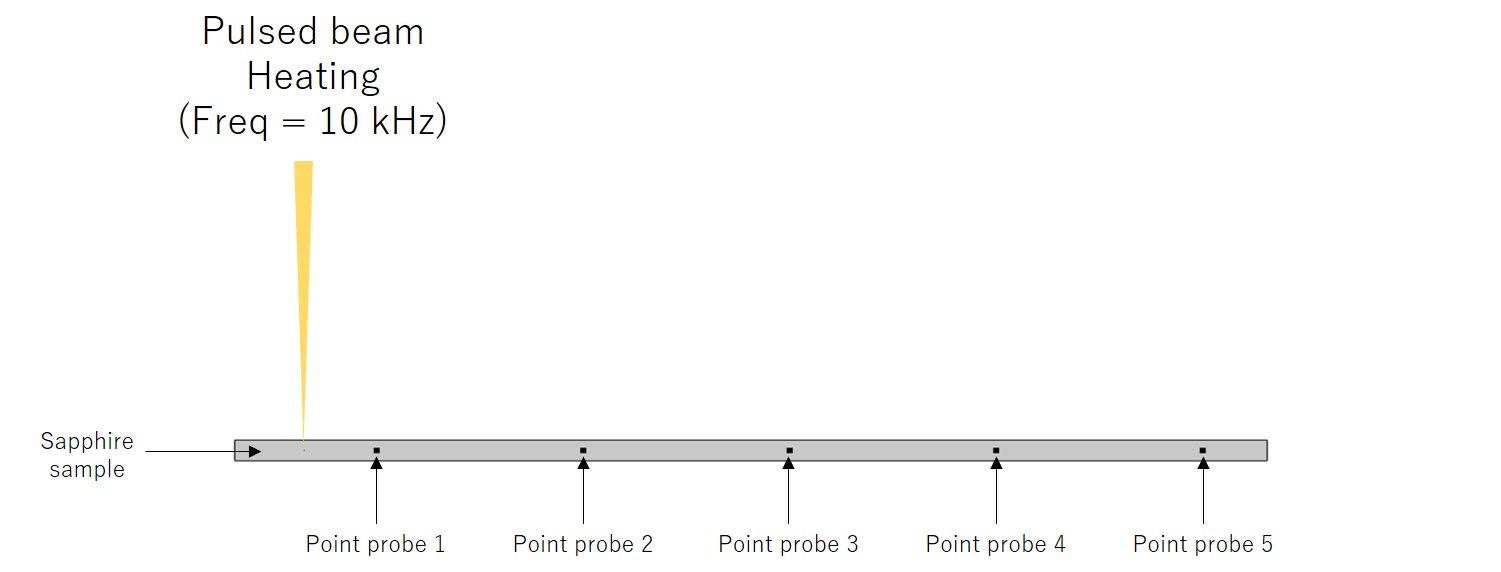

For brief summary, the experiment used pulsed electron beam to heat a sapphire sample, thereby inducing thermal waves inside the sample. In the paper, the beam (heat source) was moved and the thermocouple (detector) was stabilized. However, in COMSOL, for simplicity, I kept the heat source constant in one position and placed point probes (1 to 5) along the length of the sample, as described in the attached "Schematic figure.jpg" file.

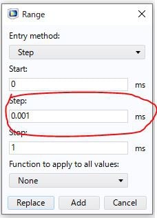

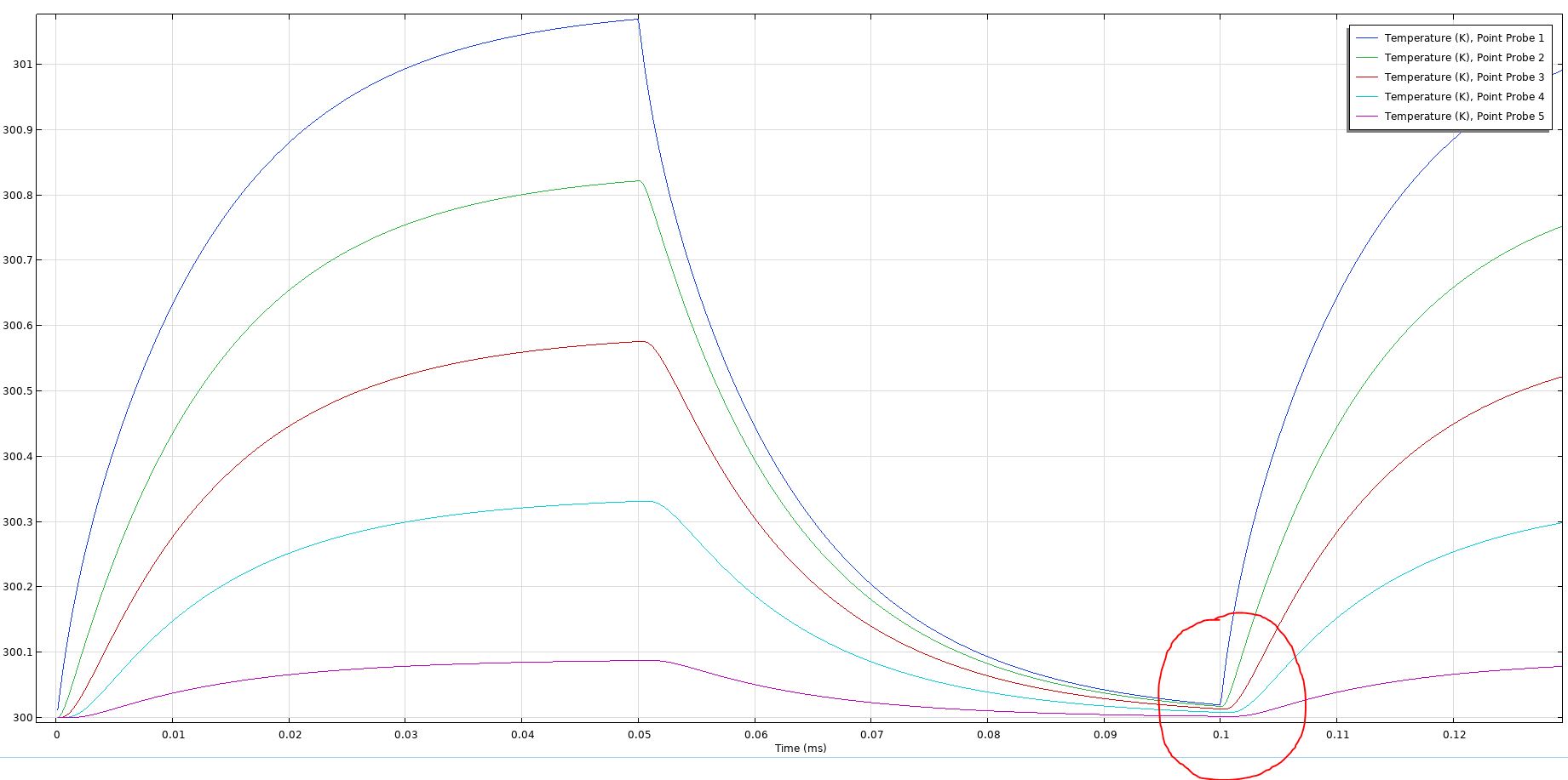

However, I don't really understand your 1st comment regarding several time step. I guess what you meant is I have to decrease the step, so I decreased it 10 times to be 0.001 ms rather than the original one 0.01 ms as in the attached image [time steps]. (The period of excitation is 0.1 ms). Still, the result was not consistent (phase delay between the largest (detected nearest the heat source) and the smallest thermal wave (furthest from the heat source) should be about 45 deg, but it wasn't as in the attached image [phase delay]).

I think I didn't notice your time units and I thought they were seconds. 0.1 period should be quite sufficient.
I am away from the computer and also I don't have any particular intuition about what your results should be. In your position I would look for any known analytic solutions.
