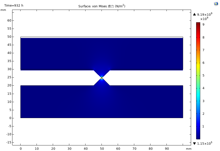

In this research, I try to use limestone to be the material and consider it as brittle. My expectation is when I give the upper rock block specific displacement per hour to move downward, the contact area should get high local stress and the contact area will gradully increase because the compression is continued. Finally, the local stress will decrease because of the increase of the contact area until it lower than critical stress and stop to fail.
After I set Rankine's Failure criterion and run,the result seems like a little different (Fig.5.). The two point is contact and the area is increase, but the figure looks like they are not actually break more like it's deformed inward. I'm not sure my setting is right or not, or comsol does'nt allow this simulation way?
