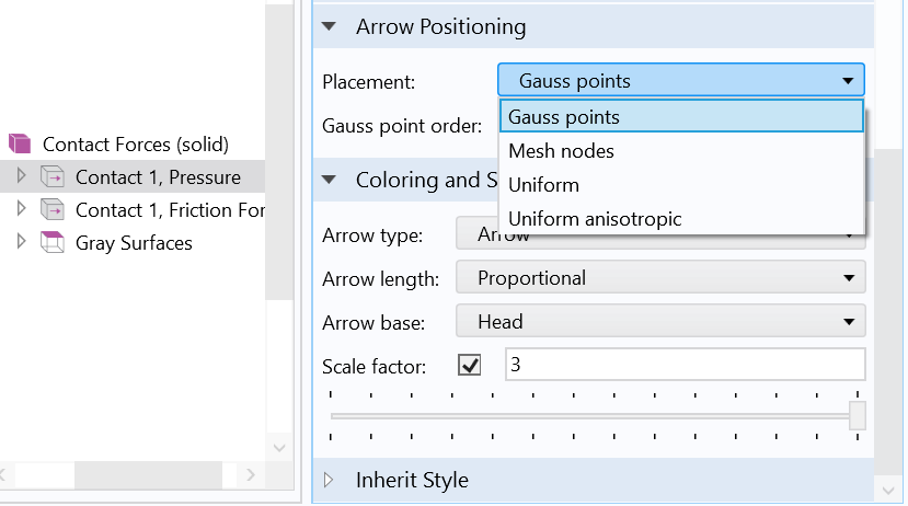

When there's contact in solid mechanics simulation, there's an automatic node "contact forces" in results. There are Contact 1, Pressure and Contact 1, Friction Force nodes under this node. The density of the arrows (pressure and friction) under these two nodes can't be controlled, as when clicking "uniform" in arrow positioning, no arrow is plotted. Gauss points is the only option but the downside of doing so is that the arrows are too dense if the mesh is fine. How to overcome?
The contact forces are shown using a standard Arrow Surface plot. So it has all possible settings for controlling arrow placement and density.
-------------------Henrik Sönnerlind
COMSOL
thanks but as the attached picture, it looks different from an arrow surface plot
There is no attached picture?

please check this attached picture related to my question
Pictures and screenshots are mostly not very useful. Consider to post the model.
