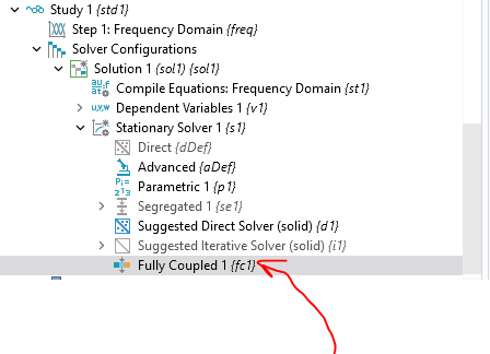

In the model, there are no frequencies listed in the study step. I am not sure what frequency you are solving for as this may affect the convergence. With regard to the error for maximum number of segregated iterations, you could try switching to a fully coupled solver. This should be more robust.
