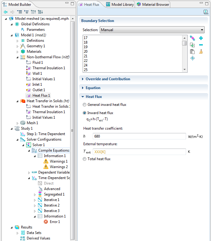

How can I use functions like interpolation, Rectangular etc,,,
you can replace your XXX with something like T0[K]+DT[K/s]*t where T0 is a constant scalar representing the initial temperature in Kelvin, and DT is the temperature increase with time (the numbers and units are typically defined in the Parameter section with the Parameters T0 and DT)

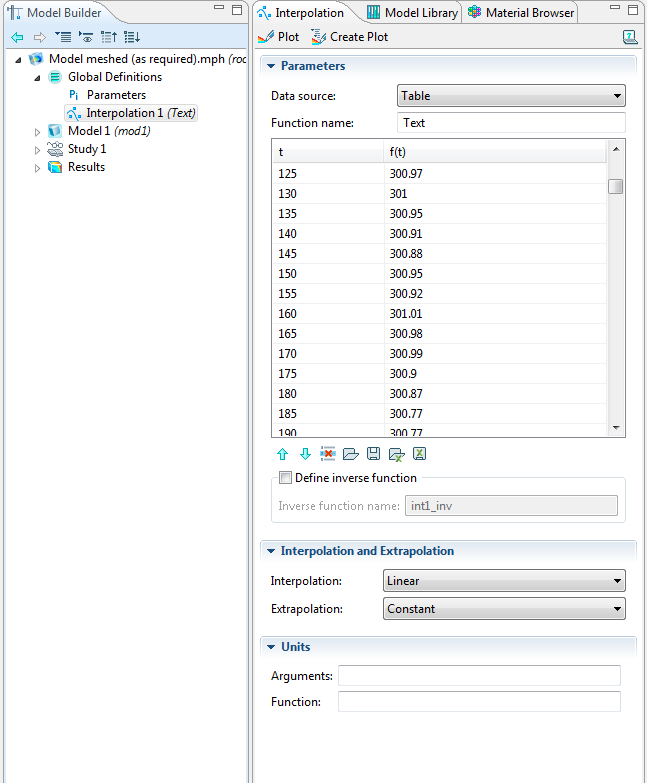

But sir, I have created an interpolation as in the image for ambient temperature. where t is time and f(t) is temperature at that time. I wish to use this interpolation in inputting the T(ext) at heat flux as the outer walls of my model will be affected by ambient temperature. Can you let me know how to solve the above problem??
Please help sir...
have you tried with Text(t[1/s]) the [1/s] is to transform the variable t with units into a "pure" number expressed in seconds
But sir, what value will it take if I give like that?? Will it take the same value of Text given beside that particular time or will any algebraic process take place??
And, Is it okay if I give the external temperature values like the given interpolation or do I need any special heat flux definition to incorporate variations in temperature as the heat transfer takes place??
while the solver steps through the transient study, going from your first to the last value, it will, for each new time step, calculate the value of Text(t) you have given, it will interpolate between the values
Thank you sir... that's a great guidance. Can I take it that I have given the input in a correct way and the results aimed in terms of temperature variation through the elements of my model can be obtained with these inputs?
