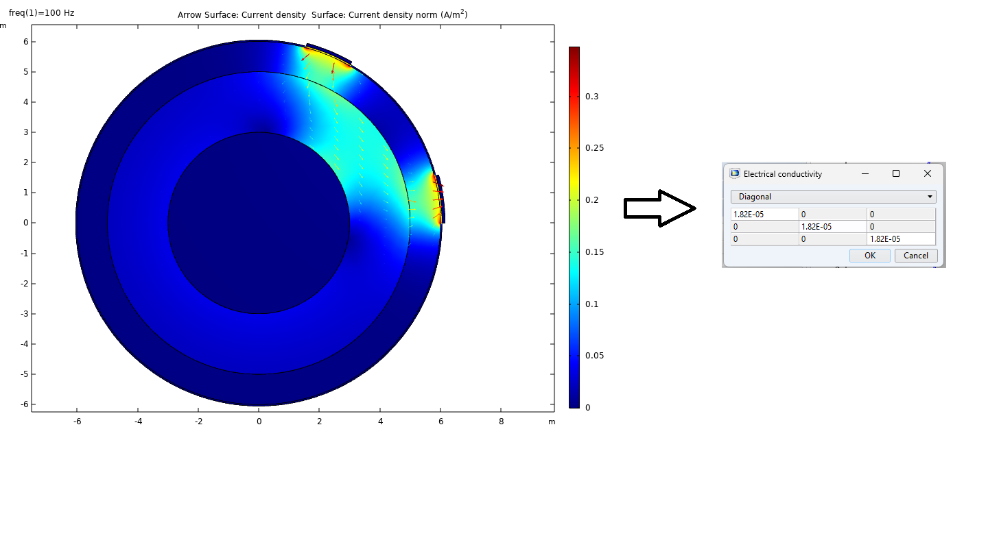

Edgar, one more question, if I know the axial and radial conductivity value of a material, how can I introduce it in this matrix, I don't know the order it should take, for example if the axial value is 1 and the radial value is 2, how should the matrix look like considering that I am working in 2D?
>Juan, > >depending on the frequency range you have in mind the AC/DC or RF modules are needed. In case you want to measure material data such as conductivity and permittivity, which are required for a model, a vector impedance analyzer is needed. > >Cheers >Edgar Edgar, one more question, if I know the axial and radial conductivity value of a material, how can I introduce it in this matrix, I don't know the order it should take, for example if the axial value is 1 and the radial value is 2, how should the matrix look like considering that I am working in 2D?

Hi Juan,
you enter the x-, y- and z-component into the matrix diagonal. You must use expressions that transform the cylinder coordinates into cartesian coordinates. I recommend to define variables in order to keep the entries in the matrix short.
It is quite straightforward but maybe somebody can suggest a more elegant method.
Cheers Edgar
