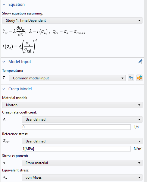

Attached is a screenshot showing how this is handled for the built-in Norton creep law. Usually this law is written as
where is the strain, is the stress, and n is a power that is usually not an integer. This causes the coefficient A to have awkward units. (There are other problems too, for example you must know the unit in which the stress is measured.)
In order to avoid non-integer powers of units, we introduce an arbitrary reference stress, so that the equation is transformed into
Then, A will always have the unit 1/s. It will also not change its value if you change the unit system for the stress.
