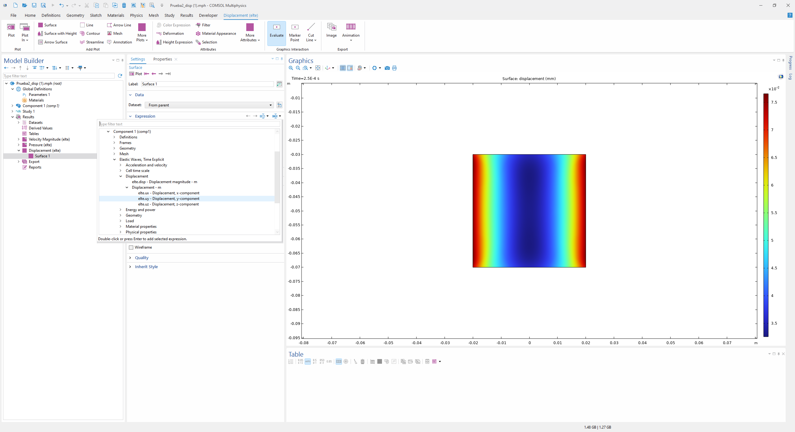

Hi. Is there any way to compute and plot only the y displacement (axial) instead of the absolute displacement and export the data in the Displacement plot?

If you look through the list of available expressions available for postprocessing in your Surface plot, you'll see one called elte.uy that seems to be the one you are looking for.

I am referring to displacement. I think “elte.uy” refers to the position, or am I wrong?

It's the displacement in the y direction, see the attached file.
