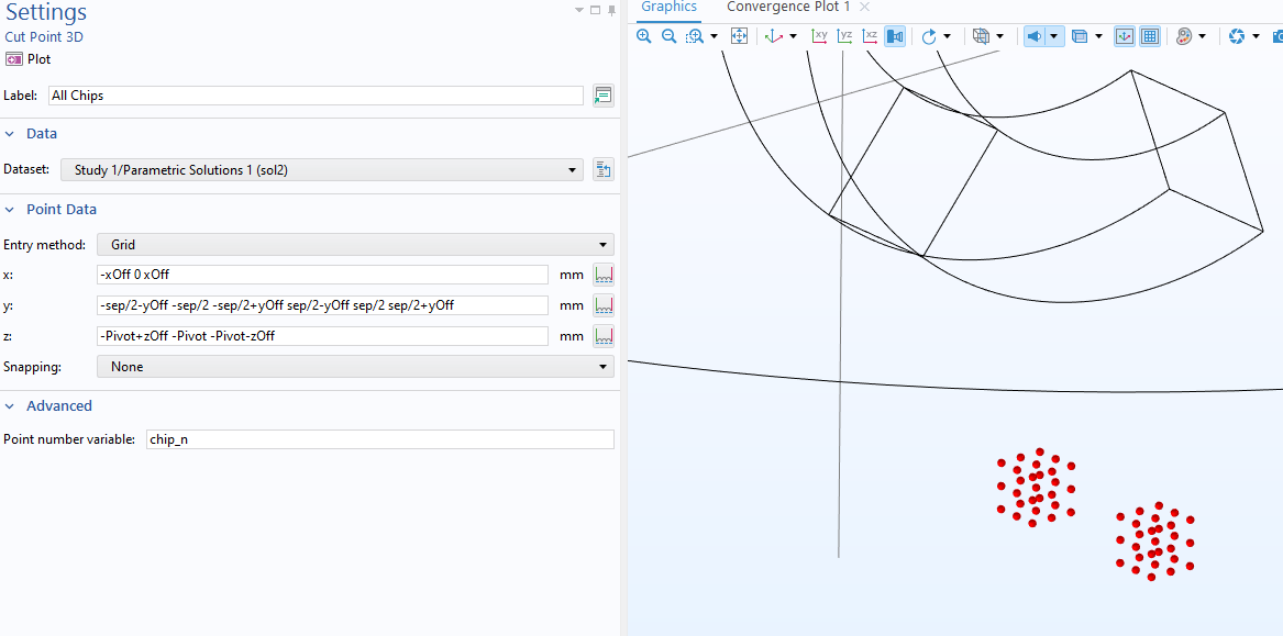

just a wild guess: could withsol() do the trick.
Cheers
Edgar

Hi Edgar,
I did try looking into using "withsol()", but I still couldn't see how to develop an expression that drills down to an individual point within a dataset. The examples in the manual don't really relate to what I am trying to achieve.
Thanks for the idea though!
Will let you know if I find out a suitable method.
Mark

There's no expression syntax for referring to a point that has a certain value of chip_n. It might be possible to do what you want using a Point Evaluation in a Derived Values or an Evaluation Group: I think that the points are ordered in increasing order with respect to chip_n, and if they aren't, then you can evaluate chip_n in addition to the expression that you are interested in. This leaves you with a table of values. You can create a model method that extracts the values you're interested in. This is admittedly more complicated that a dedicated expression syntax would have been.

Can a filter expression help in a point plot?

I think the best available solution is to use the at function.
For example, to evaluate mfnc.Bz at a position of (x1,y1,z1), you would use:
at3_spatial(x1,y1,z1,mfnc.Bz)
This is for a 3D model, you would use at1 or at2 for lower dimensions.
As alluded to above, I do not think the object model drills down to the granular level needed to expose the individual locations of a Cut Point grid dataset.
