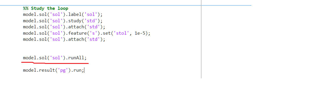

Hello everyone,
I am simulating the behavior of Litz wire using the LiveLink for MATLAB and observe its current, voltage, and resistance. My simulating model is complex (cannot be reduced/simplified/meshed further). after observing the running time, i found the following code takes 95% of time.
model.sol('sol').runAll;
can you please give me any alternative code to run the model so that I can execute it fast. I only want to record the current, voltage, and resistance.
Any solver sequence I can use for the faster simulation?
Thanks in advance

Your geometry has 2 mirror symmetries, so you can reduce it to a quarter. You can also try linear discretization.
I just realized that your model is axisymmetric and not planar. So only one mirror symmetry remains.
