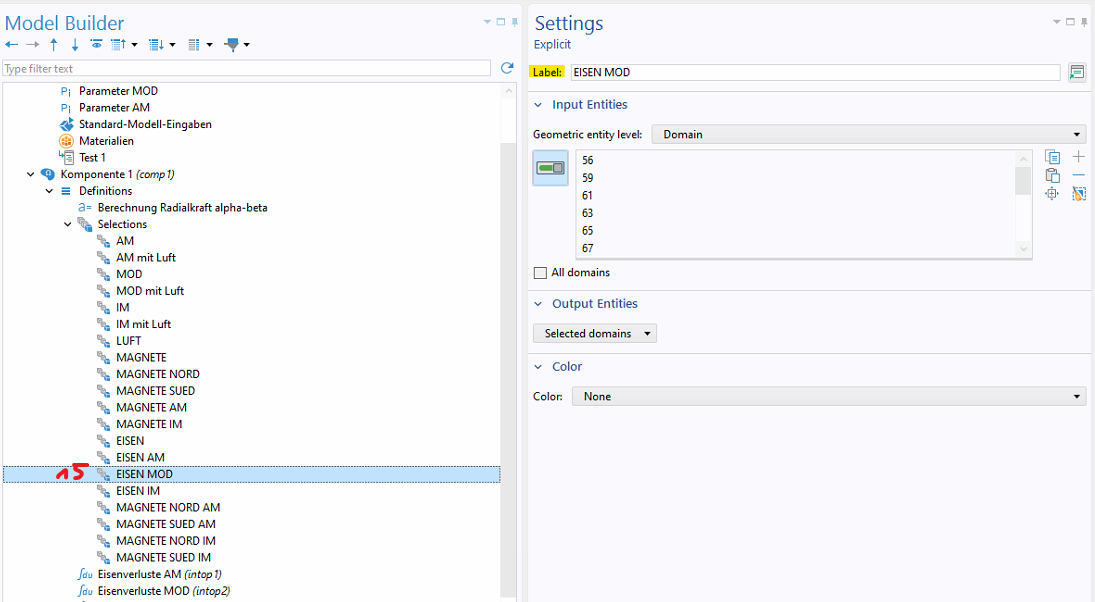

In my case, I have nearly 20 different selections (see attachment), and “sel15,” which is the 15th selection, is the one I need. If the label is not the tag, is there a way to change or view the tag of a selection? Additionally, when I create a new explicit selection, I don’t see an option for assigning a "tag."

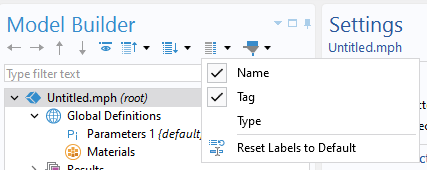

Every feature in the model has a tag and a label. By default only the label is shown in the GUI, and it's only the label that you can change - you can think of the tag as a more permanent identification (which is why it's used in the API). It's possible to enable showing the labels in the Model Builder, see attached screenshot.
If you want to find the tag for a given label, then you can write method code that loops over the selections in the model, retrieve the label for each selection using the label() method, compare against the label that you want, and then retrieve its tag using the tag() method.
If the tag is "test", then you would use it as follows:
model.result().evaluationGroup("eg10").feature("int1").selection().named("test")
