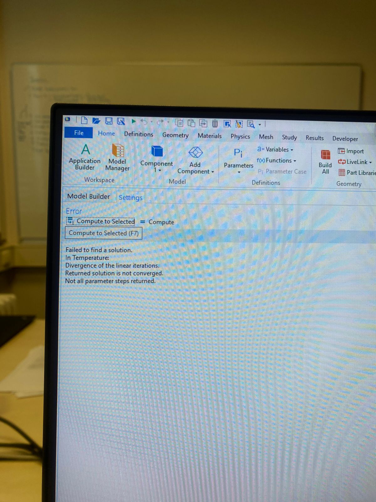

Model Description: I am simulating power dissipation in a 3D chip with RF and DC electrodes embedded beneath insulating layers. The simulation uses:
Electrostatics (FEM) coupled with Heat Transfer in Solids.
Stationary study
Applied Voltage: 100 V on the RF electrodes.
Key Assumption: Since the electrode dimensions are in millimeters (mm), I approximated the 20 MHz RF signal as a DC field (quasi-static assumption) and opted for electrostatics instead of full electromagnetics.
Error Message:
Failed to find solution.
In temperature: Divergence of the linear iterations.
Returned solution is not converged.
Not all parameter steps returned.
Note: I kept mesh normal in size.
