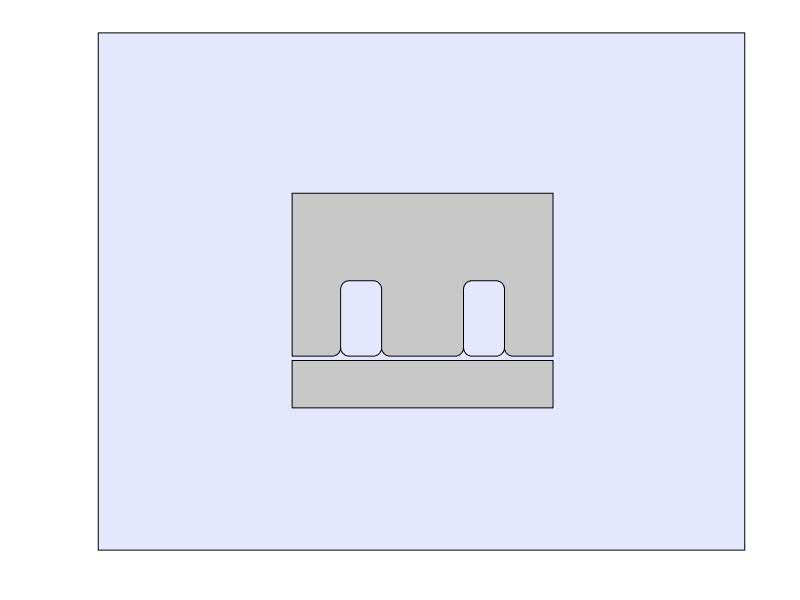

I'm modeling an E-shaped core in 2D magnetic field module. It has a flat rectangular armature that is to be attracted by the magnetic force produced by the coil. I attached the schematics.
I've faced some problems and have some questions regarding that.
First, for very small values of air gap which is the distance between the armature and the core, I expect a very large force. However, that's not what I received from my simulations. The force is very small in the beginning. After a threshold, it jumps up to a high value and follows the expected profile afterwards. I believe there is some setting that I need to apply for small air gaps that I'm missing. I attached the force profile.

force calculations are dependent on the meshing, and also on all sharp corners as here the filed is undefined (what is the derivative at an vertex, in which direction ?
Often by rounding off corners you get better results.
Then when simulating objects that move, be aware NOT to change the topology, leave a small air gap so that the geometrical ID of each entities remains
Anyhow force simulations is based that you surround your force calculation item by all air around it, multiple mu_r domains around the boundaries to integrate will give errors in the force calculations

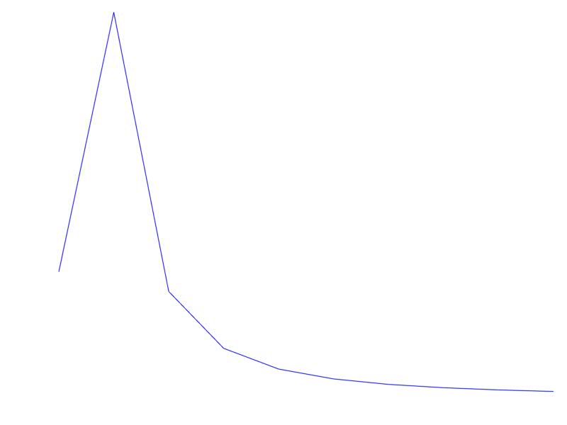

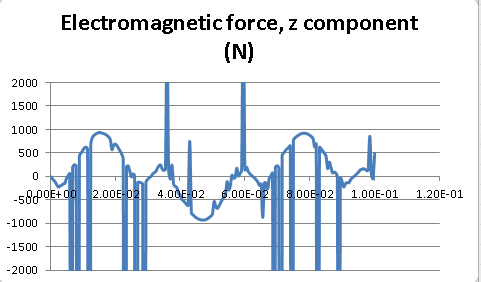

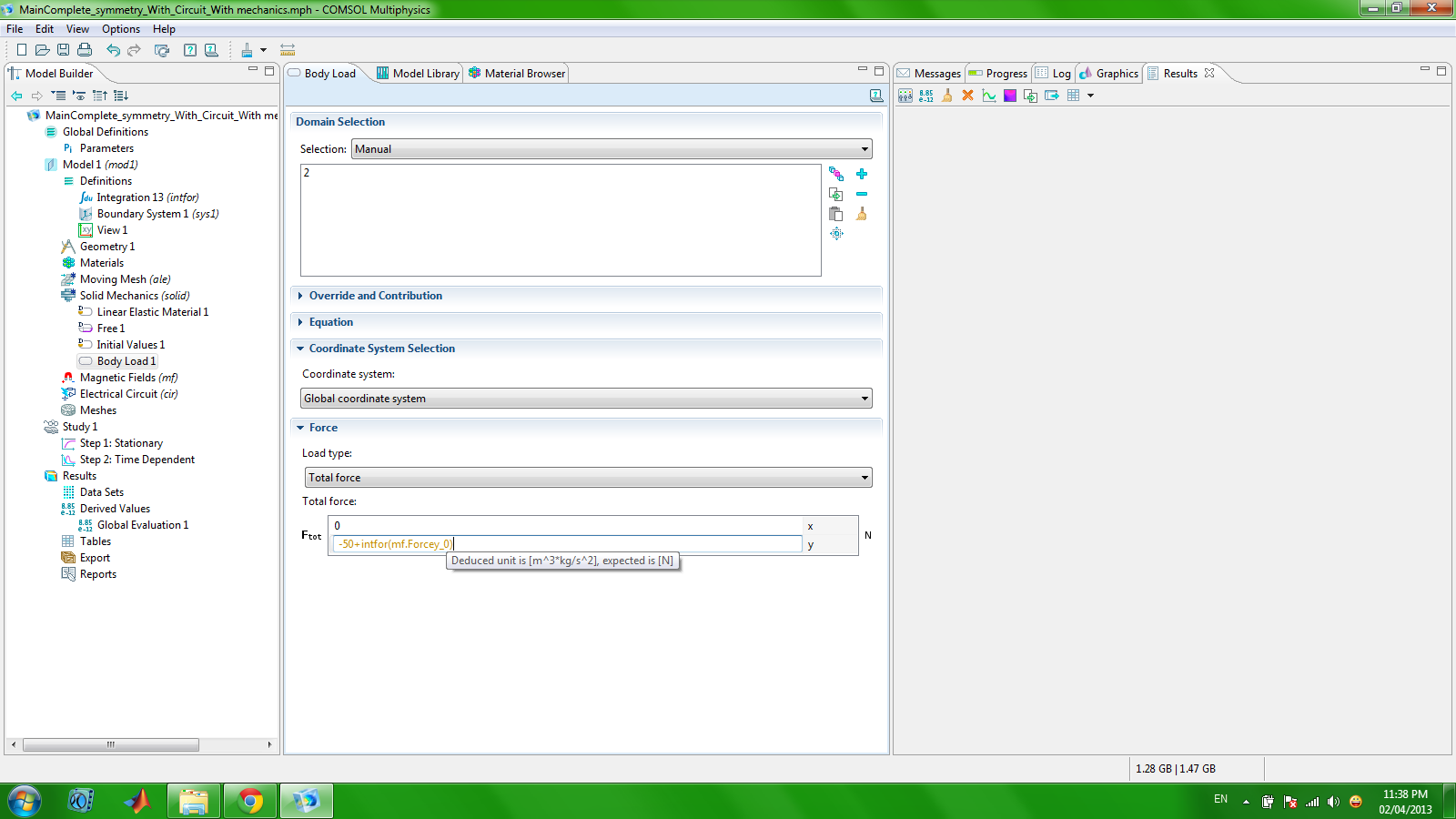

I defined an integration on the armature plate to measure the total magnetic force applied to it. When I want to use this integration in a formula, it shows up in orange text. I know that it does work with it, however, when I hold my mouse on it it tells me that the unit it can deduce from my expression is not Newton. (Please, see attached picture)
I think I'm not wrong about the formula. Do you have any idea what it can be generated from?
Thanks again
orange is unit warning (not considered as an error but might give wrong resultsif COMSOl does not interprete the values as you expect), your "50" has no units, so write rather 50[N] and then check that the units of your function or integration is ending up in N or you might have N/m and then you need to multiply by the 2D depth (probably 1[m]) to get the orange warning to turn blac (=OK)

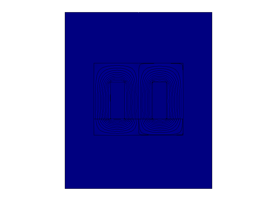

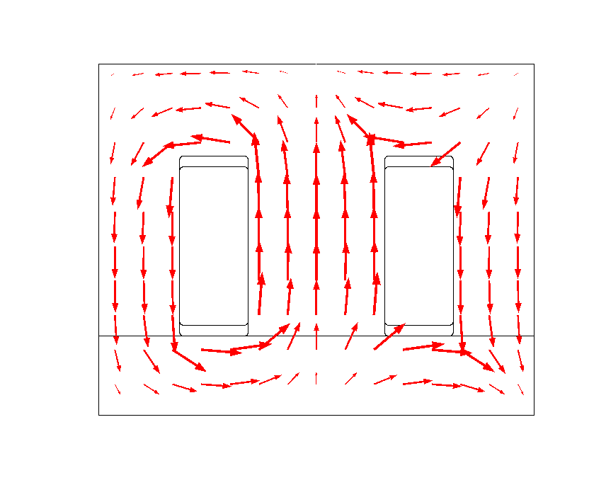

My model is in 2D and I divided my model in half because of symmetry! Is there any way I can present the final results for the whole system. like mirroring the results to have the whole system?
thanks
yes, in the Results Data set you can create a new Data Set with mirror or revolve (for 2D-axis) and give a pseudo 3D view based on your 2D respectively 2D-axi model. This is also shown in one of the videos on the main site

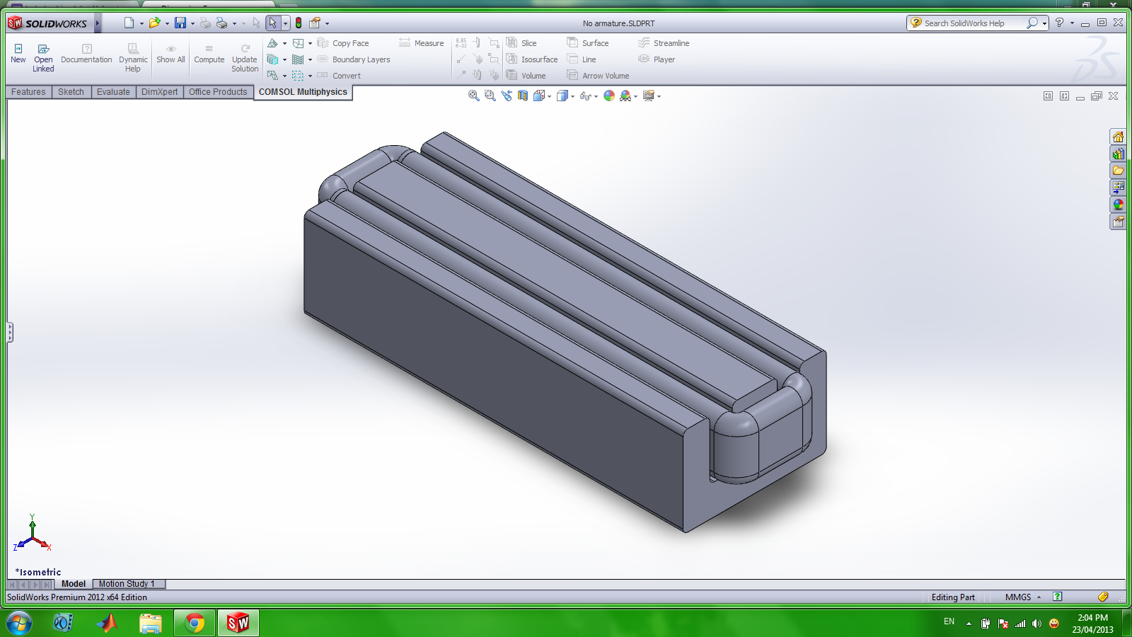

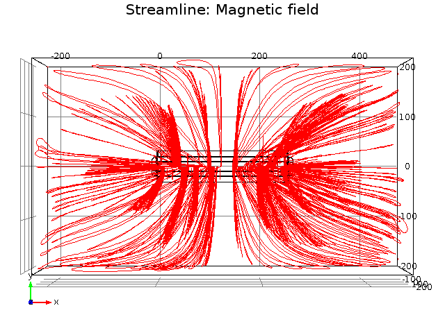

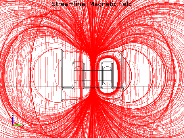

I modeled my system in 3D as well.
The force that I observe is way less than what I expect! The armature is surrounded fully by air.

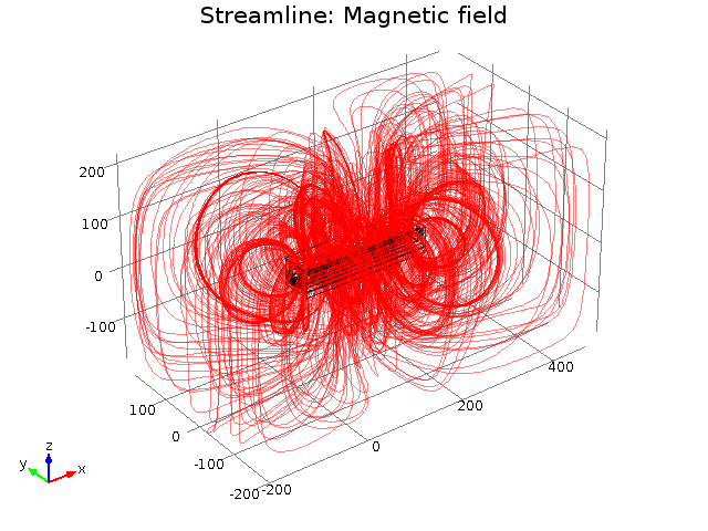

Also, when I sketch the streamlines, they don't seem symmetric! The system itself is symmetric. (Please see the attachments)
Any clues?
Thanks
first of all from that angle it's not clear how they loop around, then you must play with the plot settigs, the source, the densities, how the stream lines are started and distributed
Stream lines are Magnitude based and are for the Magnetic flux density!

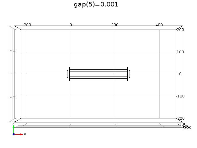

I attach the 3D view here. I also attach the front view. I don't know why I don't get a symmetric result although the model is symmetric!
Thanks
looks good like that, to perform better line selection you must study the different tabs on the GUI for the streamline plot, you might get also some hints from the videos on themain COMSOL site

In your 2D example you wrote intfor(mf.Forcey_0). If your define a force calculation on a domain, it is already an integrated force over the whole domain; you don't have to integrate manually!

Do you know any way I can access the current magnetic force in my solid mechanics modeling and use it as an input force?
thanks
The "natural way" is to calcualte the force via a MF force domain node (integration over the boundaries) and apply that as a boundary load in Solid (normally COMSOL will propose the lonk in the drop down lists)

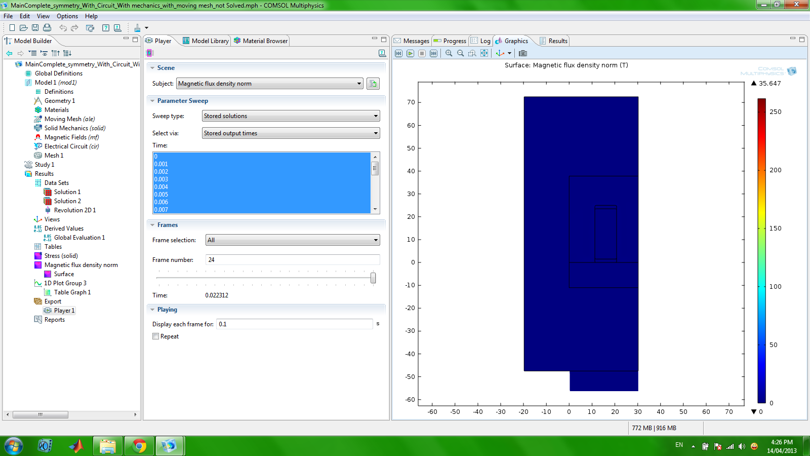

I did what you told me and it worked. When I apply the force as a boundary load it works fine; but the hanging problem arises when I do it as a body load.
Any clue?
In the post-processing, when I extract an animation, it does show the magnetic flux; but the movement of my armature is not shown.
In the past, I could get the magnetic and structural mechanics results (Movement of the armature) in the same animation. I cannot remember how I did it! :)
Do you know how I can do this?
Thanks a lot.
As you can notice, the armature's movement cannot be seen!

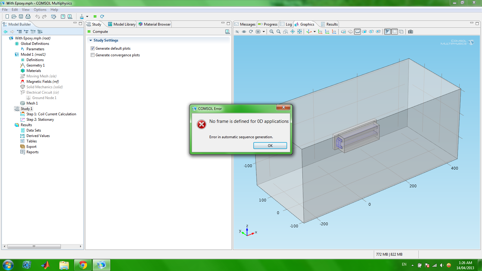

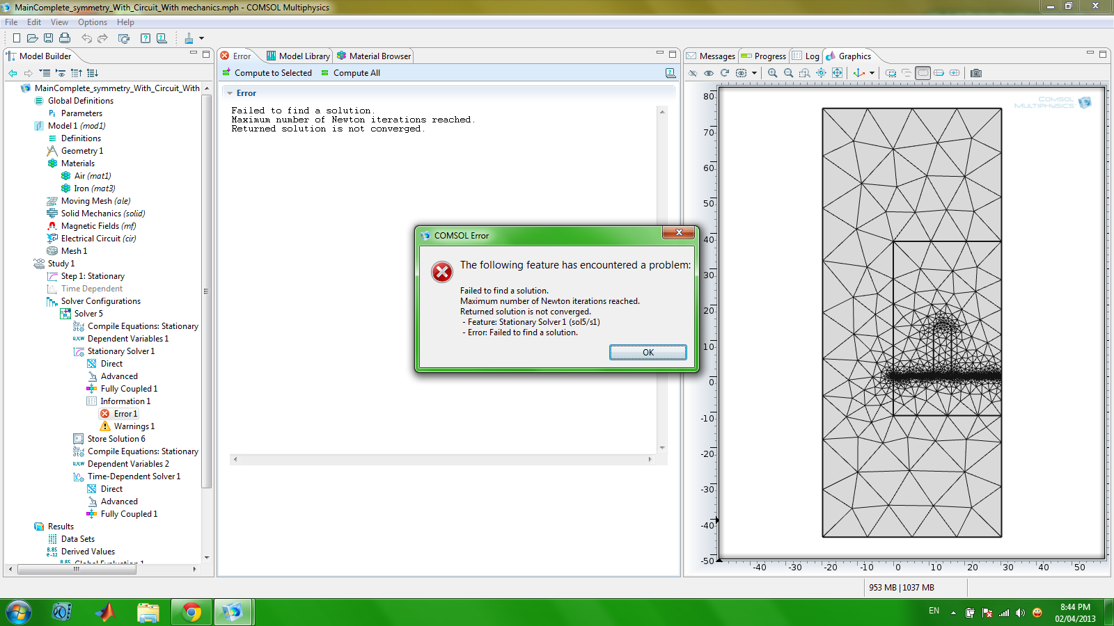

I'm trying to do the 3D modeling now. I noticed that everything is fine until I add the Electric circuit module. Even when I disable it, when I want to access the solver, it shows me an error saying " No frame is defined for 0D application". I am pretty sure it has something to do with the electric circuit module as when I delete it, the problem is resolved!
This is exact same problem in this forum:
www.comsol.com/community/forums/general/thread/34984/
But, there is no solution for it, what so ever!
Do you have any idea where this problem may have arisen from?
Thanks
Indeed I agree the 0D equations are typically the electric circuit ones, probably there is a node linke iisue as you cannot graph your node/net map it's easy to make errors. On the other side, if you have "just a resistance or a source you can model these without the CIR phyiscs too, it's only when yo have a comlex load, or a full feedback circuit loop that I use CIR physics, for that it is very nice, but a AC source term or a simple resistive load can be added as a weak constraint too
But, my electric circuit is disabled! Why does Comsol care about it?
Could you please take a look at the attached picture and see what is happening when I try to run a player! :)

sorry but from what you show there I cannot see anything "obvious and wrong" but the details are in the numerous sub nodes, the way the ALE and Solid is linked, the solver continuation / parametric sweep settings and many more

I attach the 3D view of my system. Armature will place on this part. This shows the core and the coil.
thanks
you are right, so you have a looong coil ;)
then 2D is correct but you should simulate a cut in the middle and use either a full "left" & "right" model or apply a correct symmetry /antisymmetry for the curent flow at x=0
Later you might consider 3D, but that demands far more CPU power and particularly time
