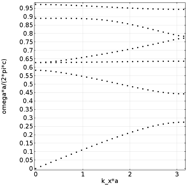

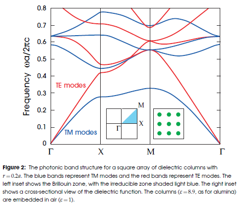

Thanks for your reply Chris,
I already figured it out with the double Floquet BC's which indeed allows me to solve for the eigenfrequencies - but only if i leave out the ports alltogether.
Anyways, i am trying to reproduce the results in the attached band diagram (using the same parameters). If i have ky = 0 and sweep kx from 0 to pi/a, this should correspond to the Gamma -> Chi segment in the diagram. As i compare my results with the reference they match pretty well, but it seems like i only get the TM solutions out. What if i want the TE solutions as well? I don't understand why the periodic BC's would restrict the polarization.
- Jens.
[QUOTE] Unfortunately I don't have the RF kit, I work with phononic systems so I can't open your model. But for a simple square unit cell, I usually have two instances of periodic conditions, one for the left-right boundaries and one for the top-bottom boundaries. Each instance of the periodic conditions will have 2 boundaries selected. For something as simple as a square you do not need to specify the destination boundaries, COMSOL will do it (although you can if you want). I assume you have defined parameters for propagation 'theta', 'k=m*pi/a', 'kx = k*cos(theta)', and 'ky = k*sin(theta)', where 'm' is very small for Gamma point and 1 for BZ boundary. Put 'kx' and 'ky' in the box for Floquet conditions. Assuming that is what you did, I don't know why you would get an error. ~Chris [/QUOTE] Thanks for your reply Chris, I already figured it out with the double Floquet BC's which indeed allows me to solve for the eigenfrequencies - but only if i leave out the ports alltogether. Anyways, i am trying to reproduce the results in the attached band diagram (using the same parameters). If i have ky = 0 and sweep kx from 0 to pi/a, this should correspond to the Gamma -> Chi segment in the diagram. As i compare my results with the reference they match pretty well, but it seems like i only get the TM solutions out. What if i want the TE solutions as well? I don't understand why the periodic BC's would restrict the polarization. - Jens.
Jens Mølgaard Pedersen
Posted: 1 decade ago Apr 26, 2013, 5:31 p.m. EDT
- Jens.
Ahh - i had chosen to solve for the out-of-plane component only, choosing the in-plane component obviously resulted in the TE-bands :)
Seems like everything is working then. Thanks a bunch for the inputs :)
- Jens
