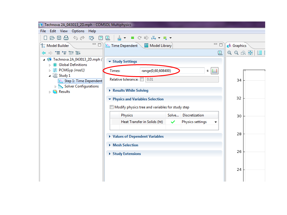

Thanks for the response.  By time steps, you mean the section under Study Settings, within the red oval in the attached picture?
Kaushik

Indeed that is the entry for the stored time steps (by default), note that COMSOL might not actually calculate all or even any, but will calculate points around and interpolate (default settings) if you want ti to follow strictly use strict or intermittent instead of Free stepping scheme (far down in the time stepping tab, of the solver sub-node
