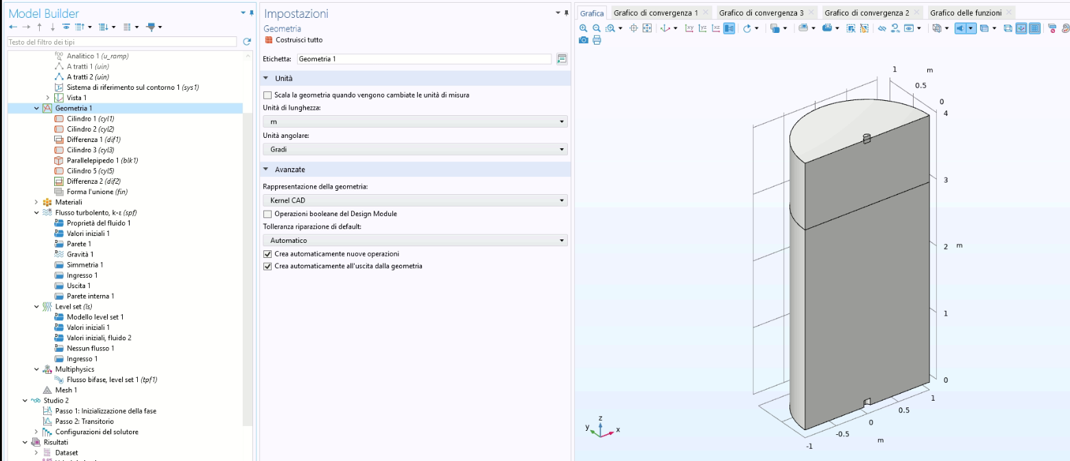

I am simulating, using the Level-Set method, a cylindrical tank partially filled with water (liquid phase, shown in red) and air. The geometry has been reduced to half of the cylinder by applying a symmetry boundary condition. From the bottom of the cylinder, air is injected through a nozzle at a constant flow rate for a time t*. The simulation was run up to a total time t,tot > t* (i.e., also after the injection stops).

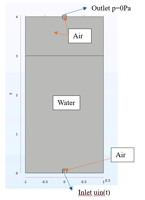

Hi, thanks for your suggestion — I’ll definitely check the possibility of a wrong negative sign. Below are some details of my setup that might help to better understand the problem, with reference to the attached schematic:
I am using a turbulent Level-Set model with k–ε, keeping the standard solver settings. The boundary conditions are as follows:
  • Top surface (outlet): pressure outlet with p = 0 Pa

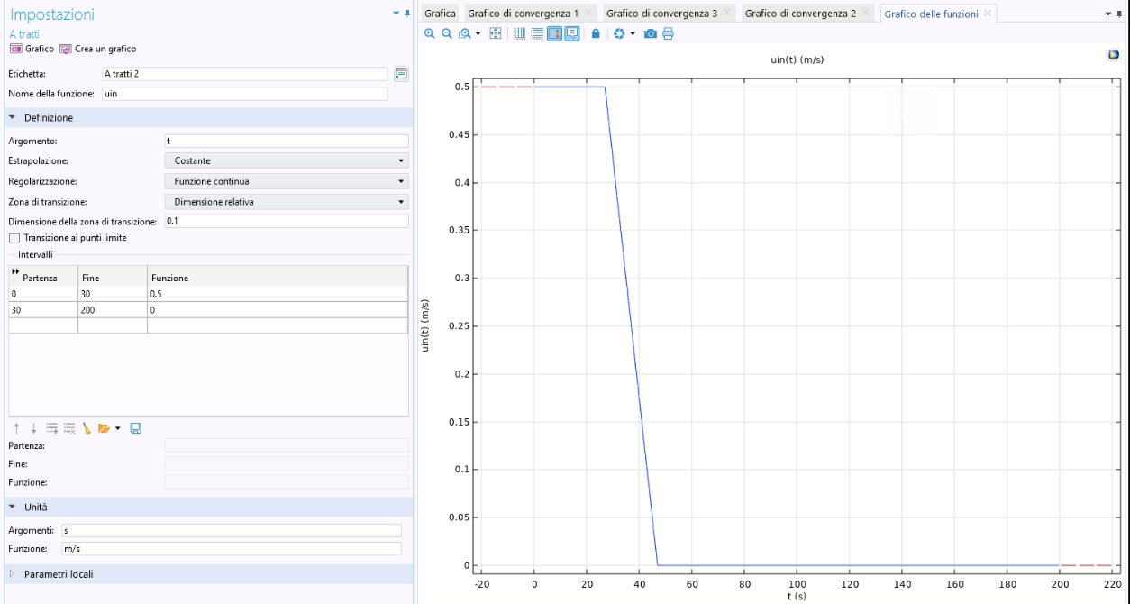

  • Bottom surface (inlet): velocity inlet defined through a piecewise time function. Specifically, for t<30s the velocity is constant and equal to 0.5 m/s, and for longer times it is set to zero
  • Lateral surface: simmetry.
The mesh is the one automatically generated by the software (default “normal” type, without special refinement). The transient simulation was run in the time range (0, 0.5, 200) with a relative tolerance of 0.3.
